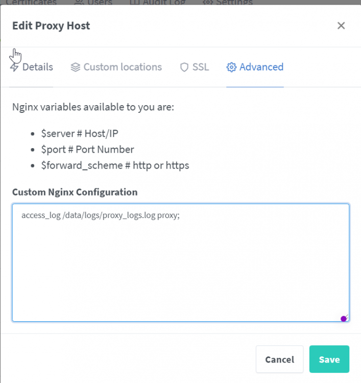

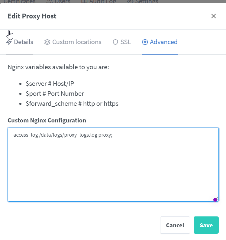

Ok - I found a MUCH easier way..... After making the changes to goaccess.conf to be: time-format %T date-format %d/%b/%Y log_format [%d:%t %^] %^ %^ %s - %m %^ %v "%U" [Client %h] [Length %b] [Gzip %^] [Sent-to %^] "%u" "%R" log-file /opt/log/proxy_logs.log Simply add the following line to each proxy host in NGINX Proxy Manager - Official "advanced" access_log /data/logs/proxy_logs.log proxy; like so: (if you already have advanced stuff here, add the line to the VERY top) Now they all log to the same file, and same format, simply add the line to all proxy_hosts and remember to add it to any new ones.
