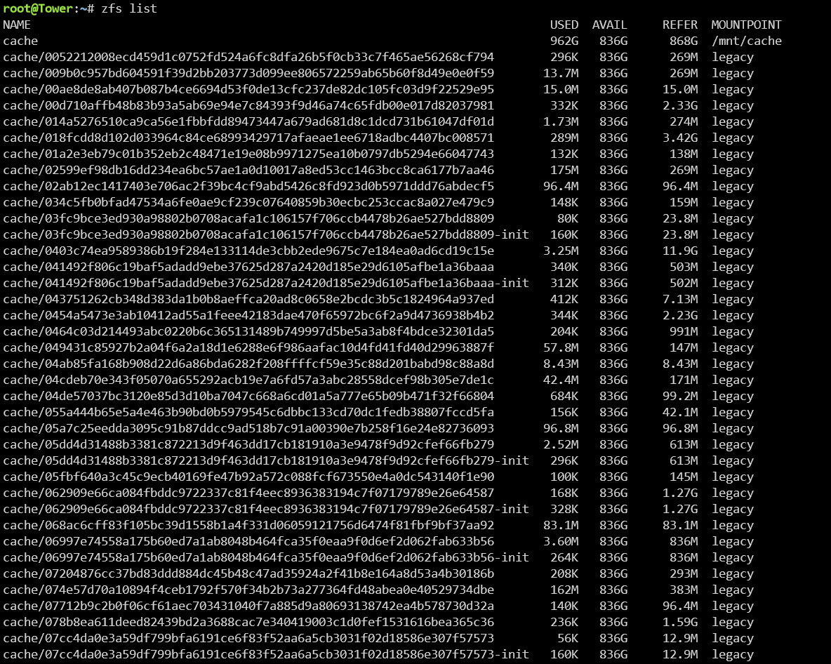

  15. And how can i efficently remove them? There are hundreds of them. I cant go through them one by one and delete them manually
  16. Is it safe to delete them? Can i somehow "look into them" to make sure, there is no important data? And how would i delete them? There are hundreds of them
  17. Hey guys, i have recreated my btrfs cache pool to zfs and build up everything, but i have noticed, that i have tons of datasets randomly being created with random has names I have already tried deleting and recreating my docker directory on that cache pool, but that didnt help. So where are those datasets coming from and how can i remove them? Its quite annoying with the zfs master pluging, as i cant hide those
  18. Hey guys, i have written above already. I have a ton of datasets or snapshots (i am not sure) and i dont know where they come from? Others said its because of docker folder, but it isnt, i removed it and they still are there...
  19. Thank you, thats a great tip. I will do that. Though isnt it possible to copy over everything from system/docker/ to then docker/ without loosing or having to recreate all the dockers?
  20. Nope, neither of those helped
  21. Hey guys, i have tons of datasets/snapshots (probably coming from docker folder, but not sure). What is the exclusion pattern? I have tried "/system/.*", but that didnt work
