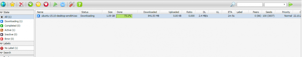

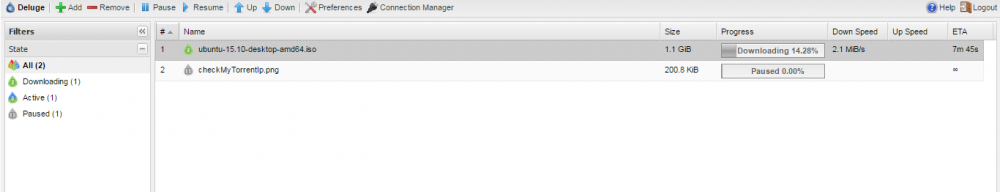

Well, the verdict is in.. rtorrent is a touch faster, but the speed difference (+0.3MB/s) is surely in the range of peer performance variation.

Houston, we have lift off Thanks binhex.. so far so good. Now to do a direct deluge / rtorrent comparo. ...stay tuned.

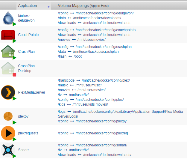

There's two ports really. The container port (which will ALWAYS be default, in this case 5050) and the Host port, or the port you access it through the unRAID IP at. Post a screen shot of the docker config for CP (folder and port mappings).

Please post a screen shot of your Sonarr docker setup for folder mappings. I would manually move them to the user share folders, then I would ensure the cache disk does not have a TV Shows folder and if it did, make sure it's empty and remove it. Afterwards, make sure your settings for Sonarr are not pointing to /mnt/cache/TV Shows/ at all. Then, see if it happens again. The thing is, if the cache drive has a share folder on it, the system may (or does) act like it's set to cache-yes.
