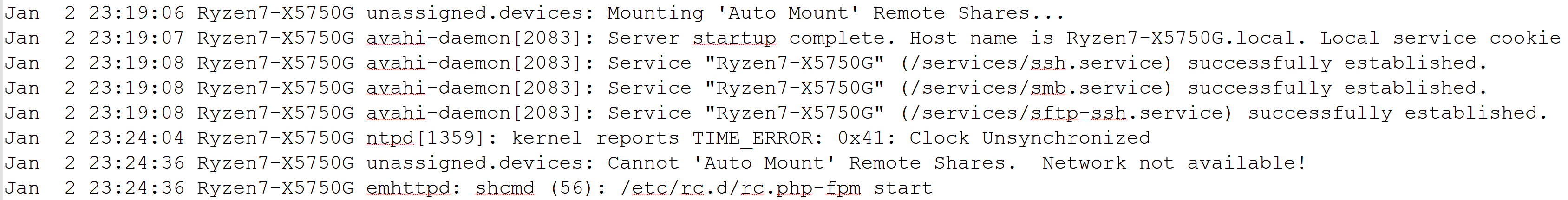

hello, I'm having this issue now on Unraid 6.10.0-rc2 and UD 2022.01.02a. After 5 Minutes WebUI is accessible. ryzen7-x5750g-diagnostics-20220102-2332.zip

thanks a lot to dlandon, you brought me on the right path to search. A few days ago, I did some changes on my firewall, and now pinging the gateway was not possible any more. I solved the problem by allowing pinging the gateway. Just one thing to think about: Unraid GUI (without UD Plugin) starts without beeing able to ping the Gateway. When installing UD Plugin AND pinging the Gateway is not possible, user gets problems (as I got..). In my "dummy user"-opinion pinging the Gateway is maybe not the best solution for checking the network.
I can ping the Unraid server that is trying to mount the remote shares.
I have a problem since last Plugin Update to 2021.04.03 on Unraid 6.9.1: Unassigned devices gets a timeout when starting the Unraid-Server, Server LOG: Apr 5 17:35:40 Ryzen7-5800X unassigned.devices: Mounting 'Auto Mount' Remote Shares... Apr 5 17:41:10 Ryzen7-5800X unassigned.devices: Cannot 'Auto Mount' Remote Shares. Network not available! Pinging the Server is possible the whole time, and Unraid GUI is not reachable. After this 5min 30sec the Unraid GUI is reachable, and I can manually (by hitting MOUNT-Button) mount my SMB Shares. For testing I deleted my all my SMB Shares: Same Timeout-Behaviour when rebooting Server. ryzen7-5800x-diagnostics-20210405-1815.zip
