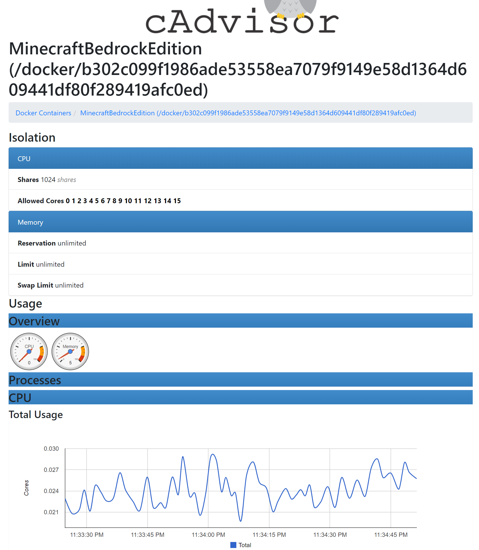

  14. Thanks. I've made no changes to the config at all. The cores are not pinned. We have tried restarting but we haven't waited the 5 minutes. We will try that tomorrow. To be more precise, it does appear to use all the cores, but only 1 at a time. The CPU is an Intel L5520. I've loaded CAdvisor and it shows the cores and dockers, but it doesn't show whether the docker is single or multithreaded. Also, we aren't sure how the share allocation is handled, so we aren't sure if it's a docker issue or something else. We have checked the network connection and we aren't seeing any bottlenecks there. Thanks again.
  15. @ich777 It appears as though the MinecraftBedrockServer docker only uses one of my CPU's 12 available cores. Is it possible for me to enable the docker to use more than one CPU core on my Unraid server?
