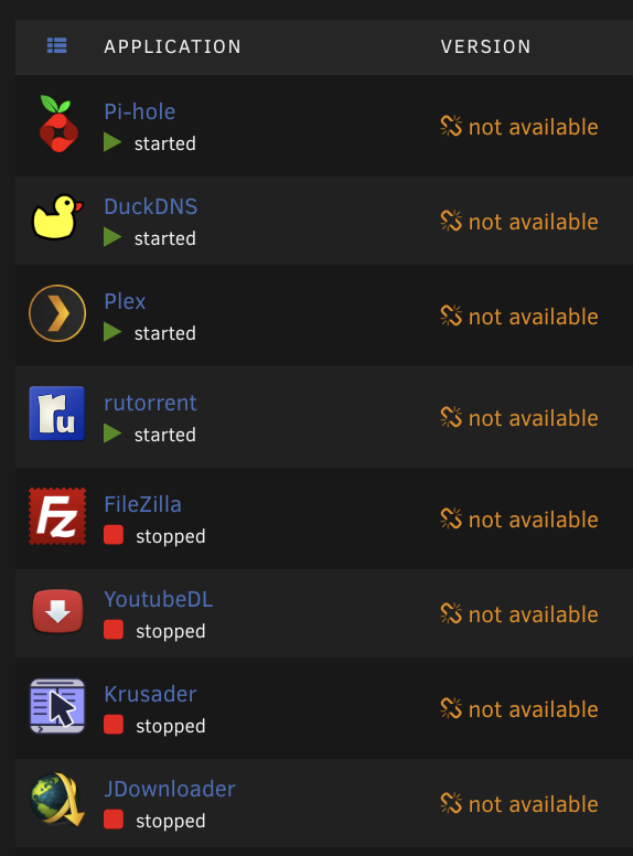

all docker containers lists version “not available” under update
server has been running for 88 days w/o issues (version 6.8.3), but all of a sudden now it lists “not available” in the docker containers tap. tried forcing update on multiple containers, and stoping and starting the array, to no avail. first time facing this issue and not quite sure a restart would fix this, or where to start.
1371711305_ScreenShot2021-05-14at7_23_38AM.thumb.png.438beb02e70ccadd5d69f8fac8265811.png
