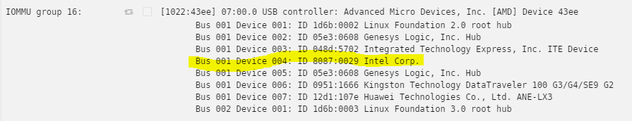

Once you move the unraid pendrive to a different usb controller you can share you diagnostics file to get more help on setting it. However, once you attach that usb controller to vfio (the one to which the bluetooth is attached) you should see it under or above the wifi 6 device, just put a check on it to pass it through (obviously you wont find any usb device in the "USB devices" that are attached to that controller, because all that devices will be automatically be in the vm): By "attaching to vfio at boot" I mean put a check for iommu group 16 (now it's greyed out because it can't be passed through, but it will become available once you move the unraid pendrive to a different controller) Note that you have other devices attached to that controller, so move them too if you need them in the host.

Not so expert, but I cannot find from your screenshot what usb port belongs to which usb controller. From this screenshot: you can clearly see that both 8087:0029 (bluetooth) and the kingston datatraveler (unraid) are connected to the same controller at 07:00.0. If you have a spare usb pendrive attach it to different ports and see to which usb controller it attaches; once you find that it attaches to a different controller, move the unraid pendrive to that port, boot, remove the bluetooth device passthrough, attach to vfio at boot the usb controller to which the bluetooth is attached and passthrough in your vm the entire usb controller.

Hope it helps in some way.. firmware: direct-loading firmware iwlwifi-cc-a0-63.ucode This means that a0-66, 65 and 64 failed to load but a0-63 is successfully loaded, and you can see in your latest screenshot the iwlwifi driver attached to it. My thought is that since it's a composite device (wifi+bluetooth) you need to passthrough also the bluetooth part: this can be tricky, since the bluetooth is attached to usb. Best option is to passthrough to the vm the wifi+the entire usb controller (not the single device) to which bluetooth is attached; however it seems you attached the bluetooth to the same controller where you have the unraid usb pendrive, so it cannot be passed through... Also follow SimonF link to prevent unraid from using the bluetooth.
