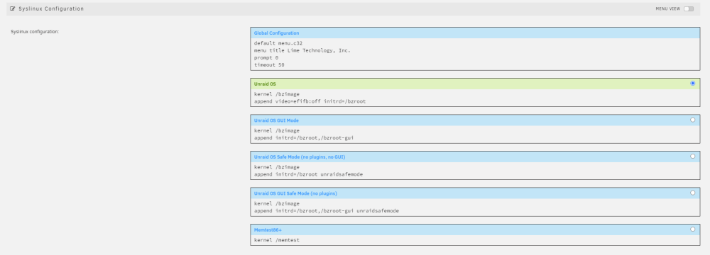

  13. Do not boot the gui mode, but unraid os, as said gpu is isolated from unraid and it cannot be used by the host (unraid), but it will be reserved for the vm. If you look at what you modified in the syslinux config you can see that you modified the "unraid os", not the "unraid os gui mode", so the efifb:off is applied when you boot "unraid os" (command line). Boot unraid os, then connect from the laptop on the lan, then start the vm. Your screenshot shows a kernel panic, system wasn't able to find root partition, this may depend on the unraid usb, try to boot again.

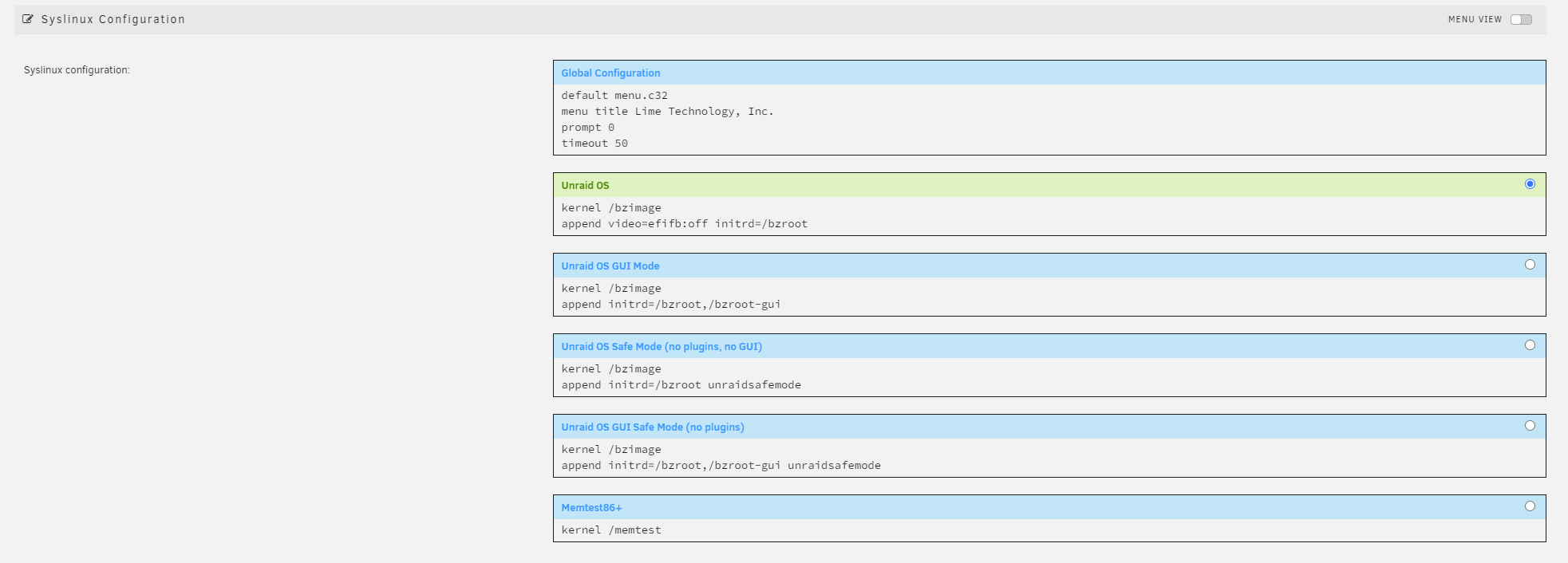

  16. xml is ok, make sure that it wont change the gpu part you highlighted after making modifications. As you can see in your logs: Feb 4 10:44:34 Akashic-Records kernel: pci 0000:06:00.0: BAR 1: assigned to efifb ... ... Feb 4 10:59:41 Akashic-Records kernel: vfio-pci 0000:06:00.0: BAR 1: can't reserve [mem 0xd0000000-0xdfffffff 64bit pref] you need to modify your syslinux config (main > flash > syslinux configuration) and add in the append line video=efifb:off, like in this picture taken from the web: Note that since this gpu is marked as boot gpu the screen on boot will seem frozen, because the gpu will attach to vfio, but unraid will boot, so connect to unraid from another device on the lan. Reboot the server. It seems also that you are using a wrong vbios. From what I found the vbios you attached is for a 3060 Ti, device/vendor id 10de:2489, subsystem 1043:8829. From your lspci your device is 10de:2489, subsystem 1043:884f. It is always better to dump the vbios directly from YOUR gpu, in extreme cases you could download a vbios from techpowerup: this will prevent you from using a wrong vbios, as it seems the case. So, dump the vbios from your gpu and use it (check if hex editing is needed, i.e. if dumped from windows with gpu-z), or if you have no alternatives and it doesn't work with your vbios try the attached one (already hex edited). 241689.rom
