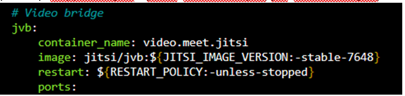

So, I figured it out: Corporate IT was blocking my "DynamicDNS host" as suspicious. No more problems. BUT, I learned a lot about docker-compose and thought I would add to a previous post as a more up-to-date guide to rjlan's guide to updating jitsi, plus a guide this simplified is something I sorely needed starting out: I: Every time unraid reboots, you will need to re-install docker-compose, here's how to do the latest rev: Find latest build at github: https://github.com/docker/compose/releases/ scroll to your relevant hardware (for me it's linux x86_64) right click > copy link for "linux x86_64" open unraid terminal window modify the following code to have your copied link, usually easiest to make changes in a separate text editor then copy/paste into command line: curl -L “PasteYourLinkHere" -o /usr/local/bin/docker-compose sudo chmod +x /usr/local/bin/docker-compose II: Back-up previous env.example and docker-compose.yml. this is just in case things go sideways and you need to refer back to something. In the unraid terminal: cd /mnt/user/appdata/jitsi/github/ cp ./docker-jitsi-meet-stable-7648/env.example ./env.example.bkup cp ./docker-jitsi-meet-stable-7648/docker-compose.yml ./docker-compose.yml.bkup (note, your "docker-jitsi-meet-XXXX" will likely be different, tab is your friend in the command line) IIa: remove old docker sudo docker stop video.meet.jitsi focus.meet.jitsi xmpp.meet.jitsi meet.jitsi sudo docker rm video.meet.jitsi focus.meet.jitsi xmpp.meet.jitsi meet.jitsi sudo rm -r /mnt/user/appdata/jitsi/jitsi-meet-cfg/ mkdir -p /mnt/user/appdata/jitsi/jitsi-meet-cfg/{web,web/crontabs,transcripts,prosody/config,prosody/prosody-plugins-custom,jicofo,jvb,jigasi,jibri} III: Now we get the jitsi docker: Similar to docker compose, we need to find the latest build from github. Under the "Assets" section, right click and copy link for the "Source Code (tar.gz)" Modify the following command to paste in your link from above: sudo wget https://github.com/jitsi/docker-jitsi-meet/archive/refs/tags/stable-7287.tar.gz && tar -zxvf stable-7287.tar.gz && cd docker-jitsi-meet-stable-7287 Please note the context here. There are 3 functions happening in one command: we are "getting" the source code at the link address && we are decompressing the tar.gz file && changing directory to the freshly decompressed directory. All 3 of these functions need to be updated to the appropriate version number or syntax to match the github link. IV: Modification of Files - Simplify this deployment and don't fuss in portainer! Since the video was released, the env.example file has been simplified, so follow the video, but understand that some options are moved elsewhere. Don't worry about it. nano ./env.example update CONFIG= directory (note, leave off trailing "/", it becomes redundant with this version of the .yml file) Timezone Public URL Docker_Host_address Enable auth=1 (recommended) Enable_guest=1 (recommended) Auth_type=internal (recommended) ctl+x to exit, "y" to save copy env.example to .env cp env.example .env Modify the docker-compose.yml to tidy things up and make life much easier nano ./docker-compose.yml Under each section add line at top: container_name: (web=meet.jitsi prosody=xmpp.meet.jitsi jicofo=focus.meet.jitsi, jvb=video.meet.jitsi) See attached photo below #1 Under "network" at bottom, add: name: external: See attached photo below #2 Create passwords: gen-passwords.sh DEPLOY! docker-compose pull docker-compose up -d --remove-orphans docker image prune Set up Authentication again (stored in xmpp.meet.jitsi somewhere, so it gets overwritten) Open a terminal to the xmpp.meet.jitsi container: prosodyctl --config /config/prosody.cfg.lua register username meet.jitsi password overwrite "username" and "password" with relevant information Unfortunately unraid will still show an update available, as the docker isn't "controlled" by unraid's Community Applications.

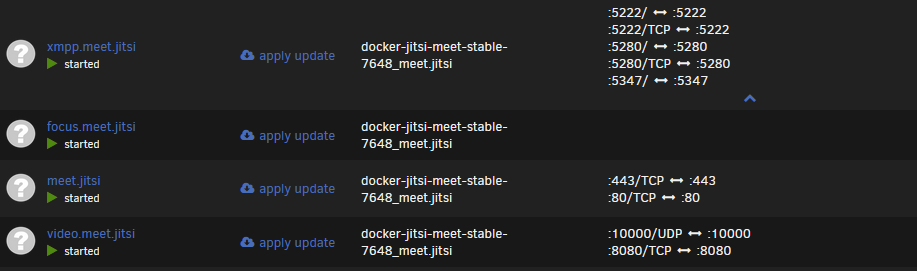

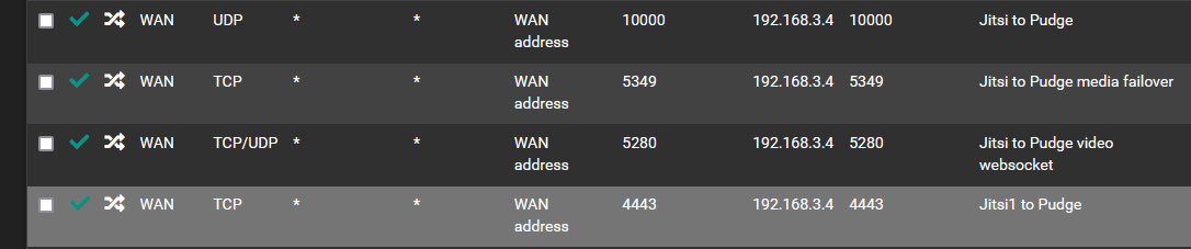

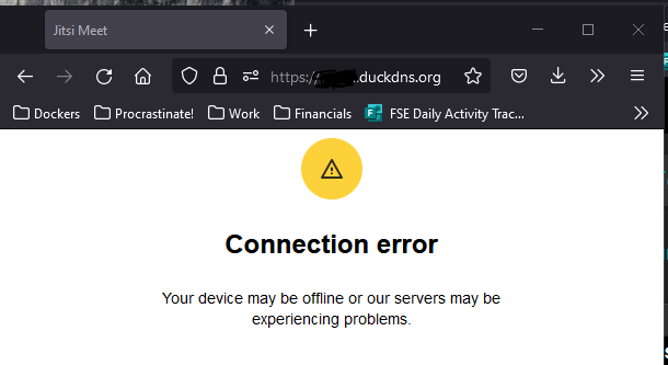

Hi Everyone, I had a Jitsi server running for almost a year and suddenly this error happened. I've tried nuking the container and rebuild, but didn't work. I can get to Jitsi via <unraid local ip>:8000 but my duckdns.org just puts me back to this error. I don't think it's a reverse proxy issue as the web page header is correct, and that particular screen is unfamiliar compared to the nginx errors I've seen with other reverse proxy failures. Did a Jitsi update push some other sort of new authentication parameters? Does the reverse proxy conf file need new info that wasn't in the old one? I'm at a total loss. Also, I understand that the docker isn't "controlled" by Unraid, but should i expect the proxynet ip address to be visible here? This could be a docker-network dns issue if the IPs are supposed to be posted here...?
