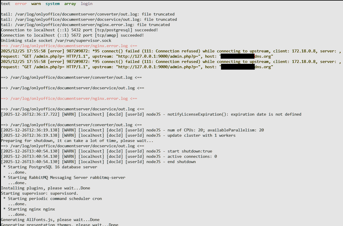

  2. Figured this out. It was a reverse proxy issue! in the documentserver.subdomain.conf file in the proxy-conf folder for swag, add the following line under "location / {". I placed mine after "include /config/nginx/resolber.conf;" # Allow for OpenOffice embedded in Nextcloud to run add_header Content-Security-Policy "frame-ancestors 'self' https://[yourNEXTCLOUDdomain].com"; Restart swag, good to go.

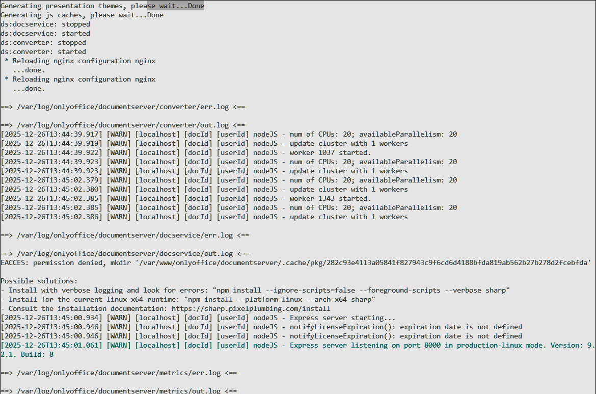

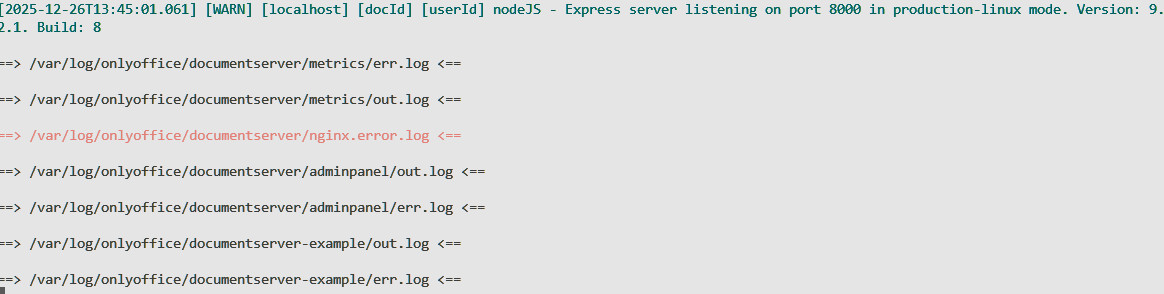

  5. I have had a working setup of OO within Nextcloud via a reverse proxy (SWAG) for a few years now. I recently noticed that the OO document server won't open documents in the browser anymore. In firefox I get a message: "Firefox Can’t Open This Page. To protect your security, [my server].dyndns.com will not allow Firefox to display the page if another site has embedded it. To see this page, you need to open it in a new window." In Edge/Chrome it just says connection refused. I suspect this is a reverse proxy config issue. Perhaps a security setting in both browsers now? No errors in Nextcloud logs, following messages in OO docker log: Can anyone point me in the right direction? preferably with specifics, please. If you need diagnostics, please advise

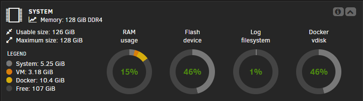

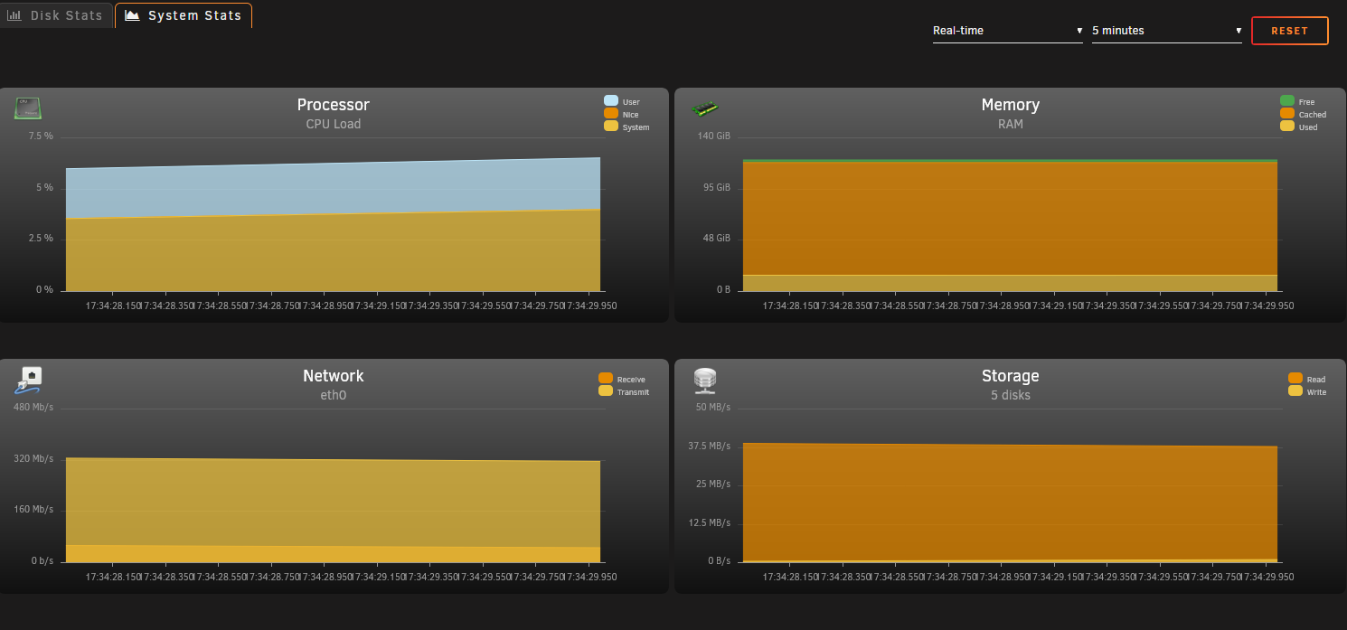

  8. Hello, I noticed that I see 2 different read backs on my RAM usage depending on if I am looking at the Main page for my server: Versus if I look at Stats>System Stats page: As you can see, they are VASTLY different in describing Free Ram. From my error reports, I'm believing the System Stats page, but I'd like to have a better understanding of what's going on here. Thank you, JP

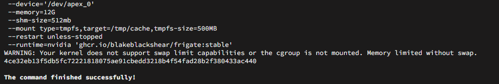

  15. Does anyone know if this message about "swap" is a problem?
