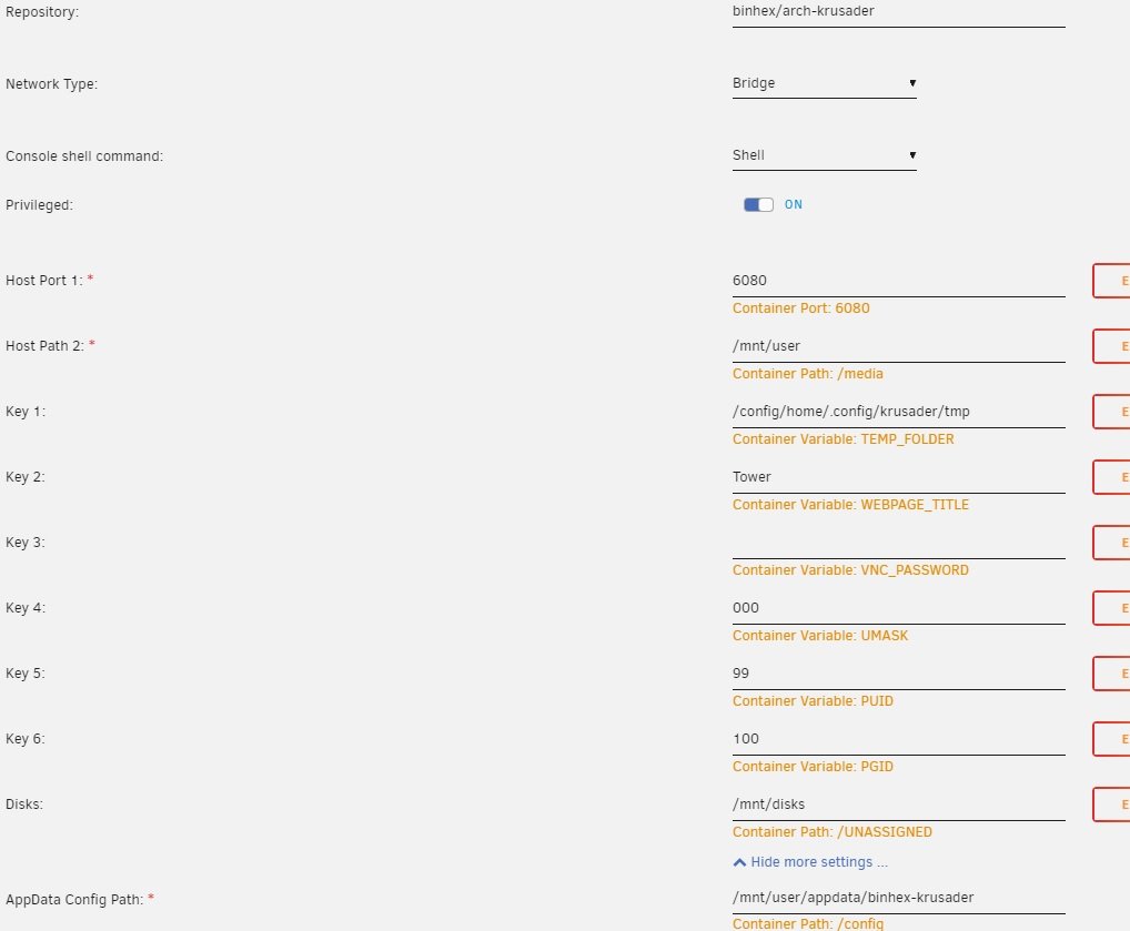

I still miss the old version (worked out of the box for me) since I am having so many issues with getting this one working, it will not even see my DISKS, and shows no UNRAID folder as well as the issue with Unassigned devices. the video by SpaceInvader seems to be for the older version and just confused the dickens out of me (not a hard difficult task...lol) Any help is greatly appreciated
