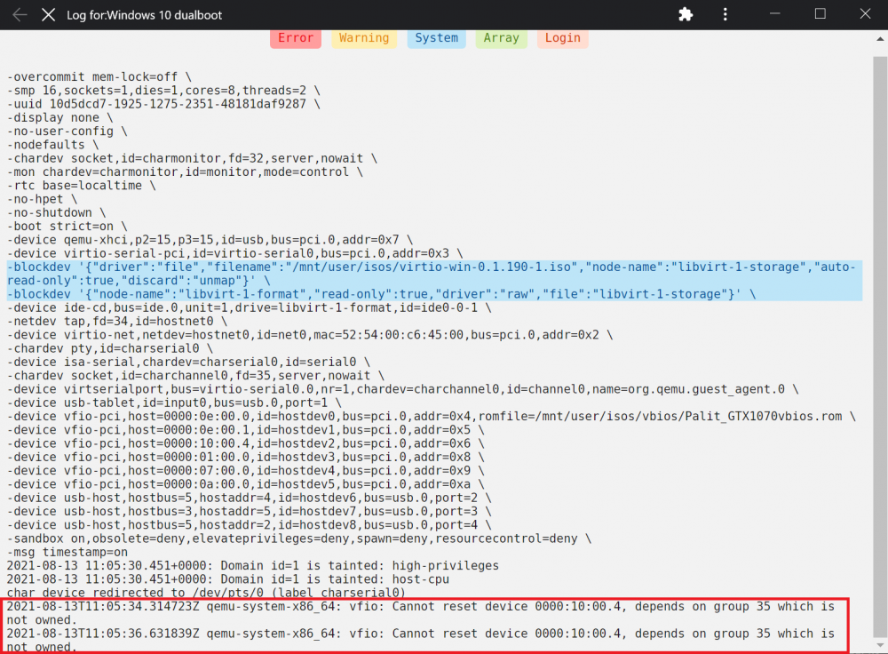

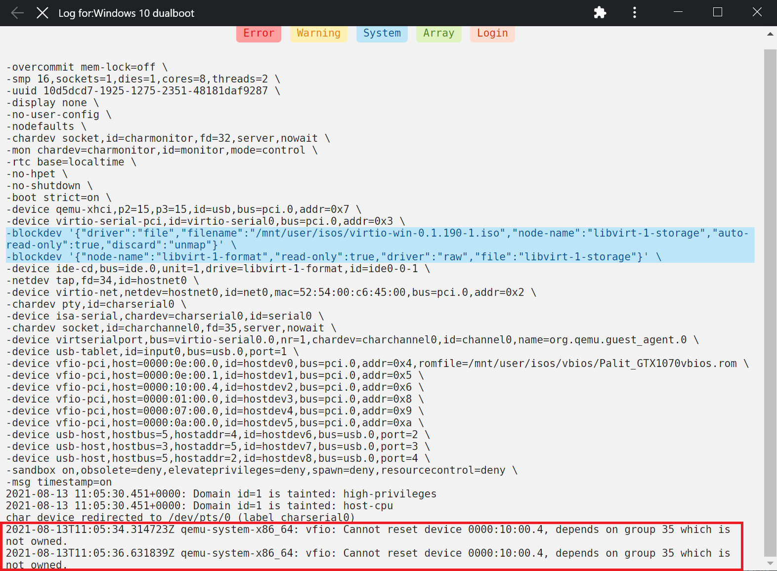

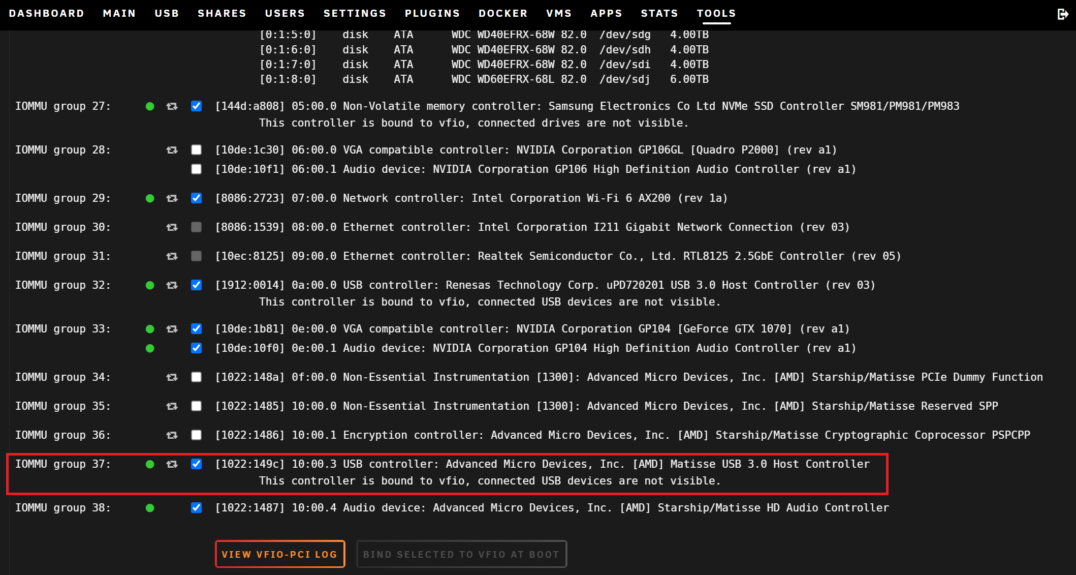

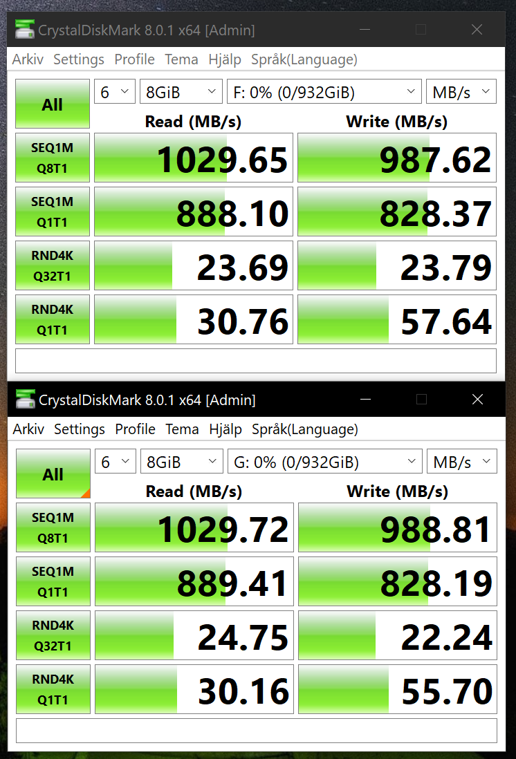

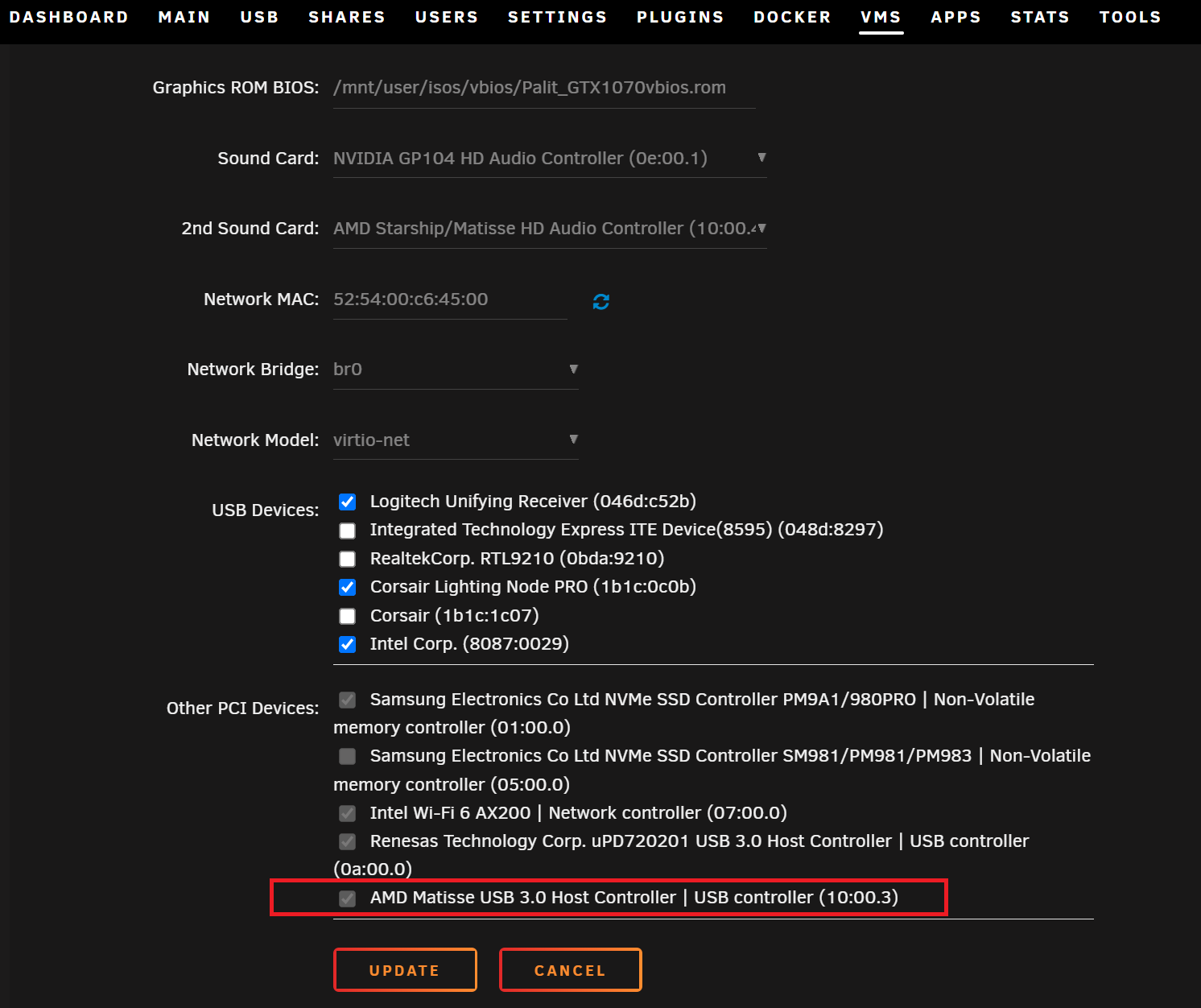

  1. unbinded to usb controller intergrated to the cpu. restart the VM & server using only the pcie x1 usb 3.0 card controller and the two external drives attached and 2.0 EHCI usb emulation, same results i did noticed demonic sound aswell using the 2.0 EHCI usb emulation. reverted back to 3.0 QEMU no demonic sound but still usb disconnects during performance tests. i did noticed something in the wm log however it did not shows up as a warning so maybe its not related.
  2. correct this controller is integrated in the cpu. the other usb controller is a usb 3.0 gen 1x pcie expansion card attached to the pcie 1x slot and this slot is intergrated to the chipset controller on the motherboard according to the manual. anyway i did followed your advice and made the same test through this usb 3.0 controller expansion card, speed is only 5gbit but the results were the same last two test. RND4K Q32T1 RND4K Q1T1 made the win10 vm freeze up a few sec and the external drives was disconnected and reconnected like previous.

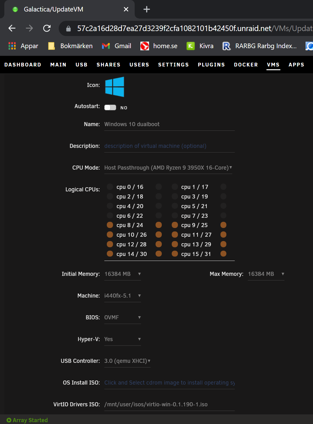

  3. both two external usb 3.2 gen 2 nvme drives are connected to the usb ports for the same controller, passtrough to the vm as per below attached screenshot

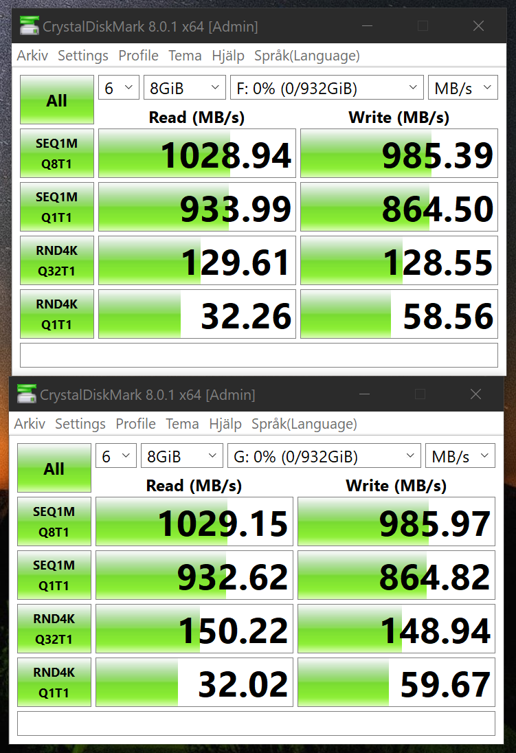

  5. hi all. just completed setting up a win10 vm and started to make some test and comparing the performance to baremetal. i have two external usb 3.2 gen 2 nvme drives. https://www.orico.me/product/nvme-m-2-ssd-enclosure-10gbps-tcm2-c3/ but when i run Crystaldiskmark test the win10 vm starts freeze up for a few sec and usb disconnect and reconnect sounds. the cursor freezes and there are sound dropouts if a play some music while the test runs. i noticed this only happened during the last two test. RND4K Q32T1 RND4K Q1T1 this two test is were the performance differs the most comparing to baremetal. are there any settings i could do to improve the performance and stabilty for these drives? plan is to use them as a steam games library. see att screenshot performance wise baremetal vs win10 vm any help would be very much appreciated
