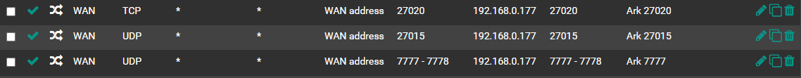

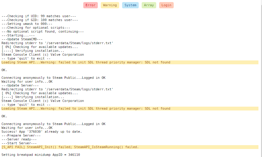

  18. For the life of me I can not get an ARK server to be visible on the Steam server list. I can see and connect to my server on LAN. I have searched this topic and Google but just can't get it to be visible. My server sits behind a pfSense router and I have the ports open. The docker is setup with default settings the only thing I changed is to add ?serverPVE=True. However, no network information is shown under port mappings. I have also tried this with the default "Bridge" network type, it did show network mappings but still had the same problem. I could connect on LAN but it wouldn't show in Steam This is what it shows in the log when the server starts. Any help getting this working would be appreciated. Also, is a dedicated Steam account needed? I setup the server without an account because it wouldn't download the server if I had my account credentials in the docker settings.
