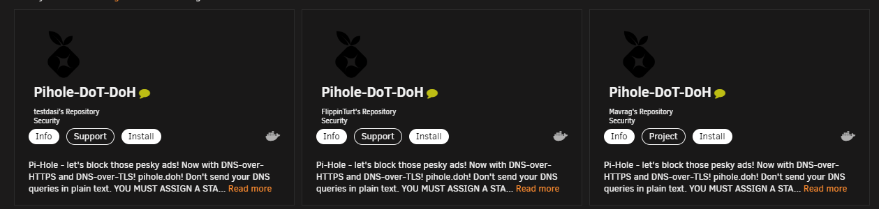

25 minutes ago, ZappyZap said:
I have fix this issue, i create a image with the fix and plan to keep updating the image when new pihole version realease , but i am not sure what to do, create an other template or else...
anyway using this for my own need so let me know
There are 2 others already, the right one seems maintained, anything different?
Edited by Kilrah
I could not found the github repo for the rigth one to be honest.
the docker hub repository is just the container , no readme, nothing else.
No support forum etc...
I was tempted t use that , but ..... because all the point above i did not
Nothing against it , but i always tried to understand and know as much as i can what i am using
Edited by ZappyZap
Is yours directly compatible with the flippinturt template? If so post the registry link, should just be a matter of changing the source.
yes actually , i did not yet bother to redo a template, i edit edit the flippinturt i had and change the image
and woila.
registry link : https://hub.docker.com/r/devzwf/pihole-dot-doh
nothing fancy all the credit go to testdasi
Edited by ZappyZap
Cool, just flipped it and all's good.
the github in on the readme if you want to check what i did
thanks for confirming
i have my 2 pi-hole instance working on this image since a week
I'm super stupid... so since flippinturt deprecated this (no hard feelings, thanks for all your hard work!) ZappyZap's maintaining a new image at the devzwf link above? How do I get that into Unraid to swap over? Or can I use testdasi's Unraid app instead like screenshotted in a post above? Sorry, I don't understand the differences in any of these (except that flippinturt's is broken).
edit your actual  flippinturt template (by left clicking on the container and go to edit)
then replace the image as shown bellow and the docker hub url as well : https://hub.docker.com/r/devzwf/pihole-dot-doh
Edited by ZappyZap
perhaps would be better for me to just create a new template....
will see
All I changed was the repo (per your screenshot) and for some reason it failed and the docker completely disappeared, lol. I was able to install testdasi's template, then change the repo and all is well now. Thanks!
