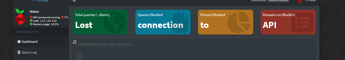

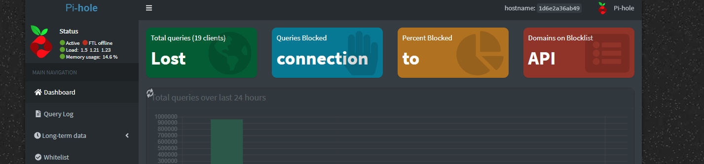

I'm having trouble with this container. I cannot get DNS or FTL to stay online. It starts out OK, but quickly fails, along with the API connection on the dashboard.
pihole_debug.log
What do your template settings look like?

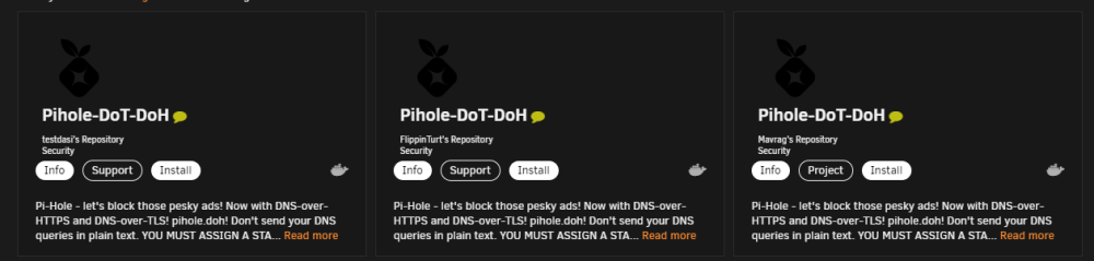

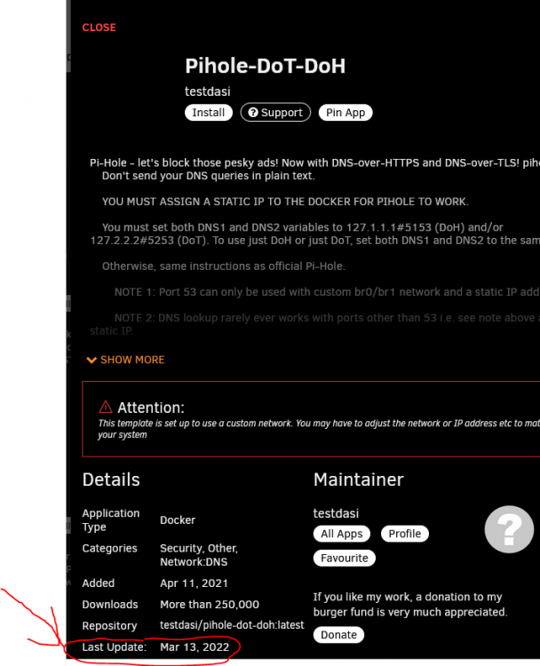

Sorry for the question, but why did you fork the testdasi's pihole?
Primarily because of the last visited date.
