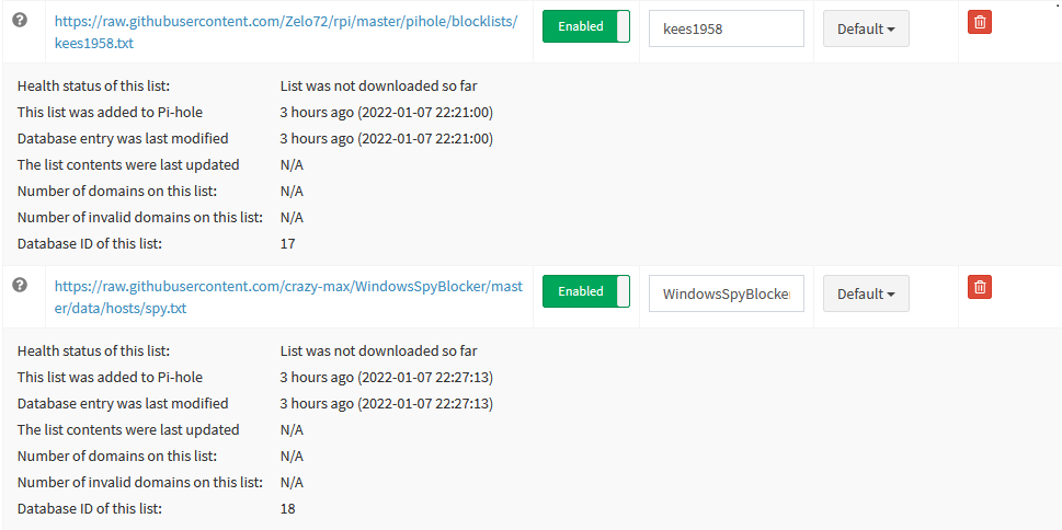

Why isn't this container downloading adlists? Whenever I add them, they just remain greyed out.
It worked when I first installed the container, but now they simple don't get downloaded or updated.
Have you updated gravity after editing the lists?
Sorry for the late response. I didn't realize there was a way to manually update the lists by inputting pihole -g into the console. That fixed the issue.

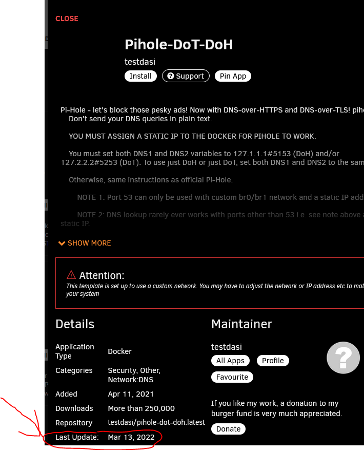

is there a reason some default settings like the interface and advanced dns settings have been changed? Especially the "permit all origins"?

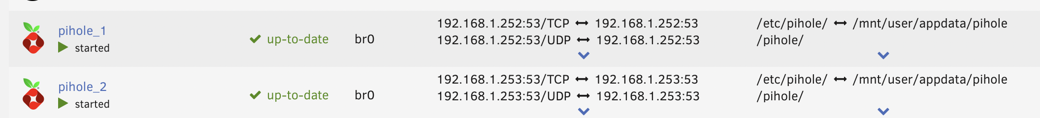

Can I have two pi-hole running using the same disk directory location?
I want to run two pi-holes for HA.
This appears to be running but maybe its not a good idea?
Thank you
1 hour ago, Abigel said:
When mine updated this morning..it pulled from:
By: flippinturt/pihole-dot-doh
The Repo is the same
I am not talking about flippinturt repo, it's about testdasi
The flippinturt repo is from testdasi due to no updates but now there is a new update
I have just had a look at the code testdasi is using to install Cloudflare and it looks like it is finally updated - so I would say that yes he has updated his repo.
Both mine and his appear to be the same now :)
Edited by FlippinTurt
