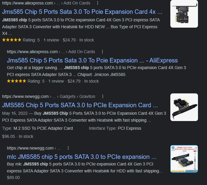

Hello, I recently got this expander card
https://www.vantecusa.com/products_detail.php?p_id=286
contacted Vantec Support to find out it is using the Jmicron JMS585 chipset. At the same time I moved Unraid and all my drives over to a different case (different CPU, MOBO, etc.)
And I'm having weird issues with my cache drive not showing up. It was originally plugged into the mobo, I tried different mobo ports and on the Vantec expander and it is not showing up. When I get home I'm gonna try taking the expander out and see if its recognized with just the original drives all on the mobo.
Posting to see if anyone has any insight on the chip or something else I should try.
Try connecting just the cache device on the board controller, it might be a compatibility issue, if the controller is based on the JMB585 chipset they usually work fine.
Figured it out. The power cables for that drive and others that was not connected on the PSU side. 🤦
And while the card seemed to work, I already ordered a LSI card to replace it, so I will be returning it. So I can't confirm the reliability of JMS585 vs JMB585
7 hours ago, jxjelly said:
JMS585 vs JMB585
That's likely a typo, JMS are Jmicron's USB chips and there's no JMS585 that I can find.

https://xpenology.com/forum/topic/58682-m2-to-sata-card-it-will-work/?do=findComment&comment=271385
Possibly, you aren't the only one to make that speculation.
But it is also a common enough typo in that case that I believed it to be a thing without having the familiarity to make and educated comparison.
All the same, I can't cancel the ebay order and microcenter is good about returns, and I need to pick up more ram. And long term the LSI card supports more drives.
