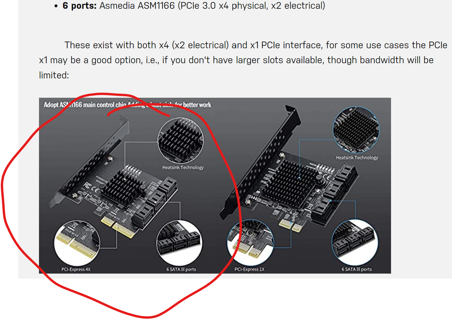

10 minutes ago, ChatNoir said:

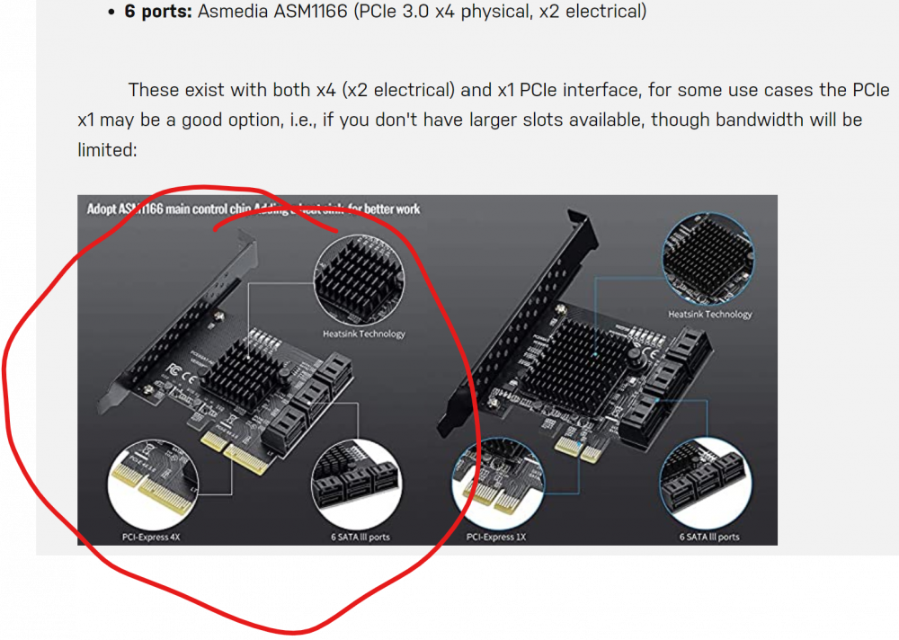

With 10 SATA ports, it must be using a port multipler since ASM1166 can only manage 6 ports.
I was mistaking above, ASM1061 is NOT a good option for 6 ports either, it's a 2 SATA ports controller. I'll correct my initial post (and your quote as not to induce confusion).
If you want 6 ports, select a controller that can handle 6 ports. There is not way to magically handle more without port multipler on SATA cards.
ok, thx.
i think i will buy this one which is cheaper
https://it.aliexpress.com/item/4001269633905.html?spm=a2g0o.productlist.0.0.2c4644d77UiQvY&algo_pvid=e6b8b850-d99d-4195-8705-f13f0ba8babc&algo_exp_id=e6b8b850-d99d-4195-8705-f13f0ba8babc-0&pdp_ext_f={"sku_id"%3A"12000022790770836"}&pdp_npi=2%40dis!EUR!!33.38!!!!!%402100bdd516545057507772709e0e3a!12000022790770836!sea

yes, there were both versions in the link. Anyway many thanks for your help
i bought that exact model and it fu**ed up 2 of my drives.
First i wasnt able to stop the array and then the whole Server was inaccesable.
After some investigation on that Card, i saw that the cooler was touching some resistors because the thermalpad was too small and the Black paint was already scrached up..

That's the problem with these cheap SATA cards, sometimes you get a good one, other times not.
yeah, now i bought a new mainboard with more Ports, that will do the job for a long time. (and 2 new drives..)
Those generic cards are hit or miss.  The one I got from Amazon caused a CRC error on one of my drives.
Get the LSI one or a clone.
