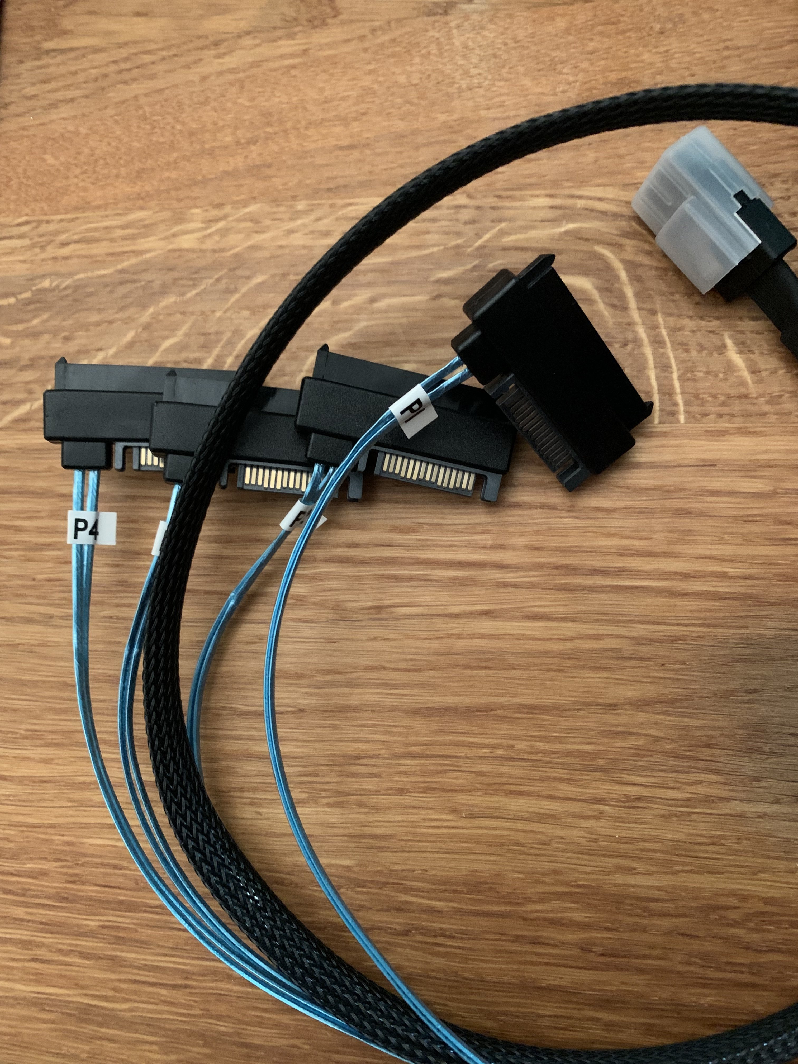

Hi, I just received my first SAS HBA.
I bought a SAS 9207-8i which already had the latest firmware and IT mode enabled.
I also ordered two SFF-8087 to 4x SATA forward cables as described in the first post.
Unfortunately, I received the following cables: AWM 20744 E170689 SAS3.0
Can I use these aswell for my WD Reds or do I need to send them back and get the SFF-8087?
Edited by Marv
SAS cables work with SATA devices, for SAS devices you need to use SAS cables only, so they will work, of course you also need to connect the power to them, seems obvious but it wouldn't be the first time someone didn't do it.
