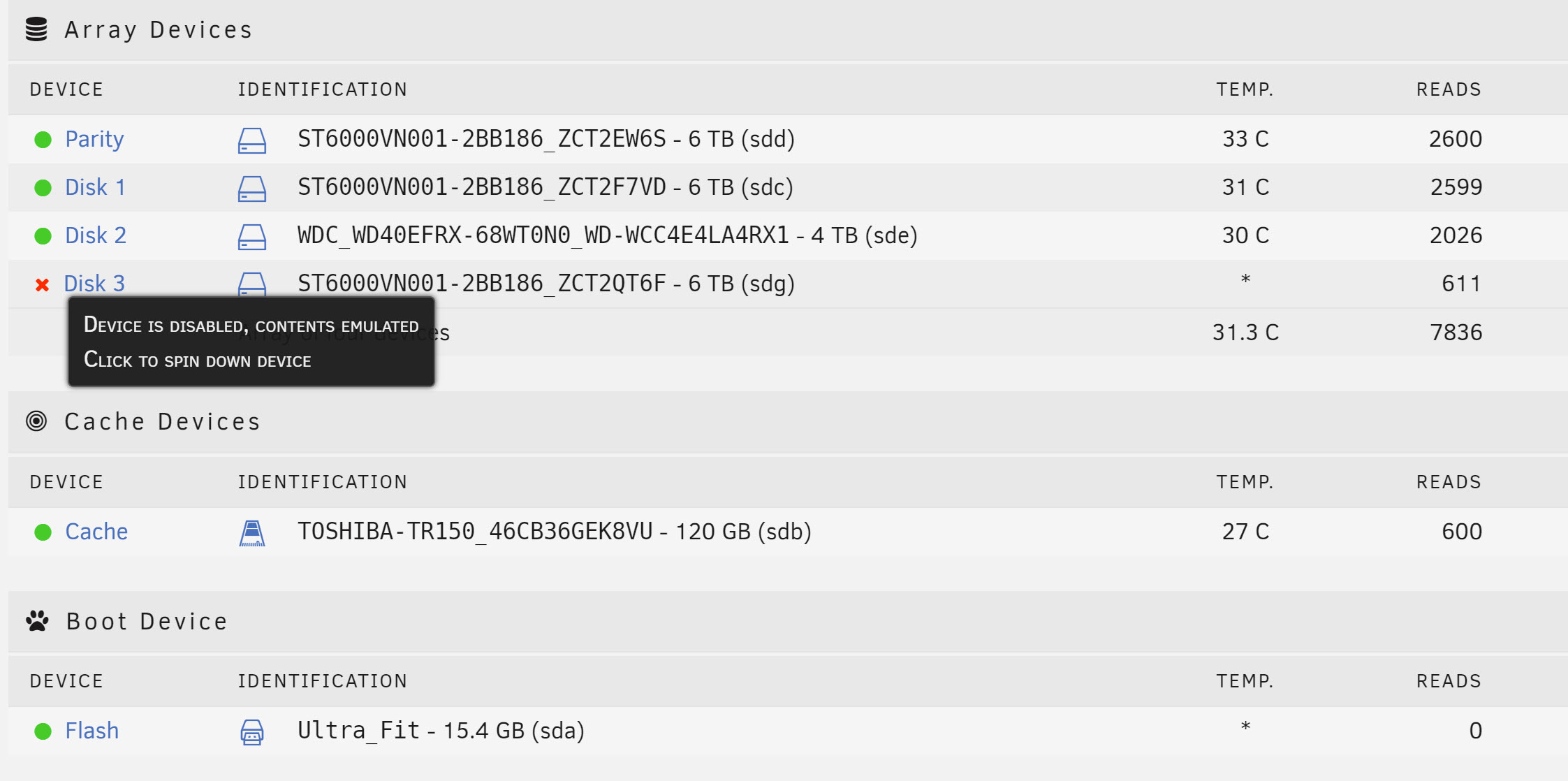

All of a sudden, one 6TB drive is "disabled" and in "emulation mode".  I can read files that are on that drive but I'm assuming "emulation mode" means it's because of the parity drive.  I

Disk3 SMART OK and as you mentioned it is emulated successfully. Since you rebooted before getting us the diagnostics we can't see any details about what may have disabled the disk except of course a write to it failed which is the reason a disk gets disabled.
Check all connections, power and SATA, both ends including splitters.
Then you will have to rebuild the disk since it is out-of-sync and the emulated contents need to be written back to the disk.
Safest approach is to rebuild to another disk and keep the original as it is in case of problems during rebuild. But should be OK to rebuild to the same disk.

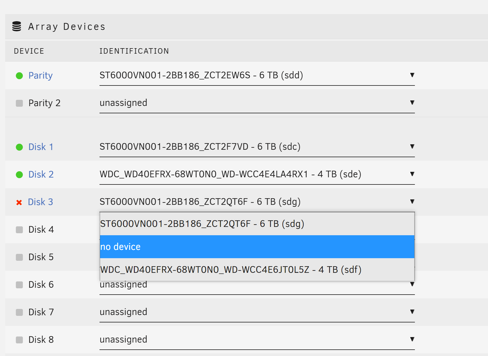

Does "unassign disabled disk" mean change disk3 to "no device" as shown in the picture?
Thank you
yes

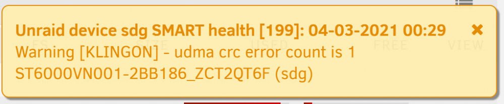

Thank you.  I followed the steps and as soon as I made the drive unassigned this error popped up.  I continued and now have it doing a "rebuild".  Is this error message suggesting a drive failure?
Thank you immensely for the help

CRC errors are connection issues not disk issues. That single CRC error was already there in your previous diagnostics. You can acknowledge that count by clicking on the SMART warning on the Dashboard page and it will warn you again if it increases.

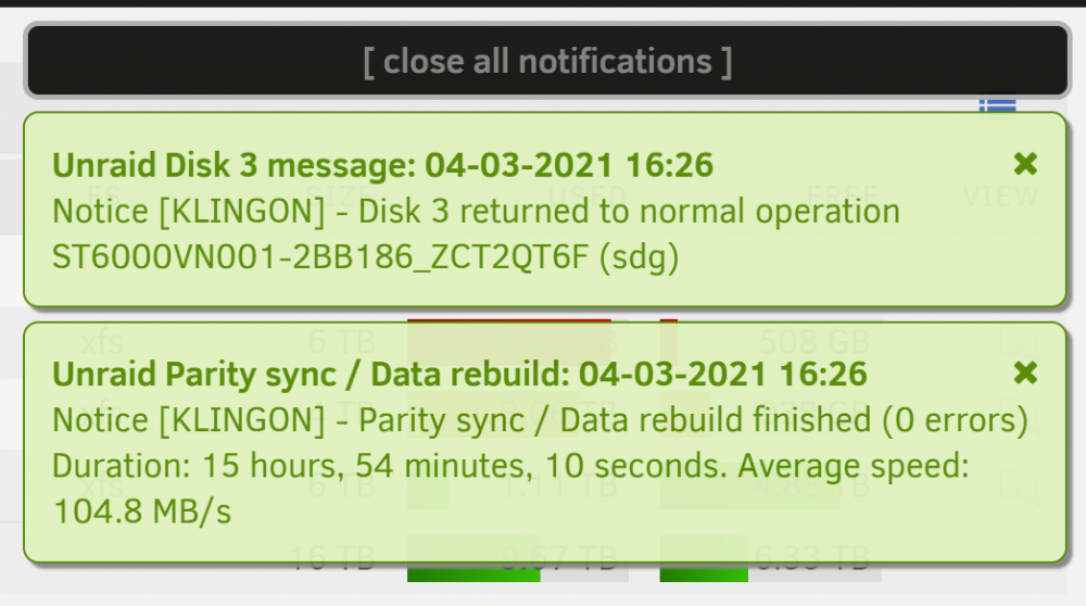

So after 15 hours of "rebuilding" it's all good !!!!!!!!  Disk3 is back online and I got these messages
I'd like to thank everyone for their suggestions especially @trurl I really really appreciate the time you took out to reply
