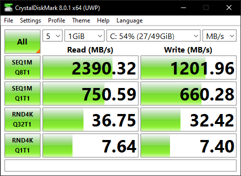

Wow you're a life saver. Thank you so much for the solution. It works as expected now.
BEFORE

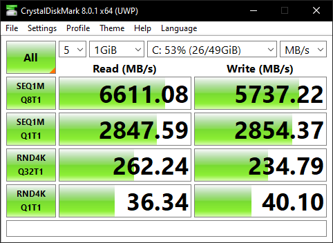

AFTER
CrystalDiskMark_20210306193727.png.c5d4c0f1e95dca0acd5f05b17aa834f4.pngafter.JPG.f07d8dd2d84b3ac0ac4ac63c3ed5ebef.JPG
Agreed, it’s night and day. I had already enabled turbo, so the improvement for me was all down to CPU scaling. Would like to understand why this needed to be changed and what other consequences will be.
