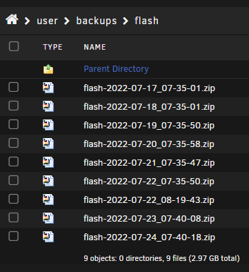

July 24, 20224 yr Community Expert I got rid of Appdata Backup and just do it myself in a daily scheduled user script. echo "Flash backup..." cd /boot datestring=$(date '+%Y-%m-%d_%H-%M-%S') zip -qr "/mnt/user/backups/flash/flash-$datestring.zip" * find /mnt/user/backups/flash -mtime +7 -type f -delete # Keep 7 days Edited July 24, 20224 yr by Kilrah
August 1, 20224 yr On 7/24/2022 at 3:36 PM, Kilrah said: I got rid of Appdata Backup and just do it myself in a daily scheduled user script. echo "Flash backup..." cd /boot datestring=$(date '+%Y-%m-%d_%H-%M-%S') zip -qr "/mnt/user/backups/flash/flash-$datestring.zip" * find /mnt/user/backups/flash -mtime +7 -type f -delete # Keep 7 days This is for USB backup? I might just steal it then.
