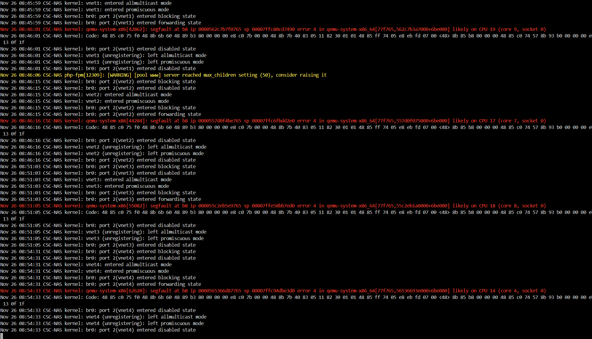

Reinstalled a new VM using Q35 and complete clean setup, but this time with no vbios and gpu from the start (no vnc) - had the identical same issue. i440 bios crashes the VM, if I Force Stop - UNRAID crashes. If I switch off GPU first (by the egpu enclosure) - then Force Stop - the VM can be stopped. Part of me is wondering if its the egpu. Any thoughts would be appreciated... -

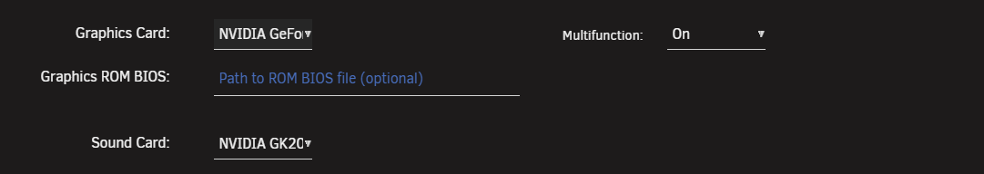

Hi I have a Ubuntu VM, with VFIO GTX1660 Ventus OC 6GB. I am passing through the Nvidia video, sound, usb, and one more (they are bound together). My Overide is multifunction. The binding has the green dots. I have tried: SpaceInvader vbios sccript - script fails, so no option No bios Tech bios download with hex editor When I boot Ubuntu if I have purged all NVIDIA drivers through VNC and then run ubuntu in GPU passthrough - The Tiana logo loads with a ubuntu logo - then i get a solid black screen (no flashing cursor) I cant input or do anything except force stop. If I purge NVIDIA drivers then install sudo apt-get install nvidia-drivers-470 I then get a black screen with a flashing underscore character. Whether I use the vbios seems to make no difference. I have searched the unraid forums and tried many things, but I am at a loss now. One option I want to try is booting in a ubuntu safe mode, the problem is i have no idea how to do this within a VM. But if someone knows the solution, I would be so grateful. Up to now everything has failed with my VM attempts and I'm sort of at the point of quitting with unraid all together, I've a good setup and is gutting to see every effort fail so badly with no help or support.

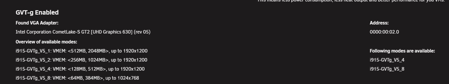

Hello Please can I have some help. I'm pretty sure I explored this before and I couldn't do what I needed. I have a AsRock Creator W480 with i9-9000k CPU I have a monitor attached to the HDMI output on the motherboard I have no GPU installed I have booted unraid to OS with no GUI In my VM for the Graphics Card, I select Intel UHD Graphics 630. I get the following error: XML error: Attempted double use of PCI Address 0000:00:02.0 I do have Intel igpu top installed - but I dont use it for dockers. I think up to now it was used for just the GUI. Do I need to uninstall. I also have Intel GVT-g installed. I can set i915-GVTg-V5_4 (i915-GVTg_V5_4: VMEM: <128MB, 512MB>, up to 1920x1200) to my KodiPlex-Server When I go back into the VM edit and select Intel UHD Graphics 630 I get the same error. Does anyone have experience and could tell me how to make the UHD igpu hdmi out be used for my VM? Do I need to delete Intel GPU Top?
