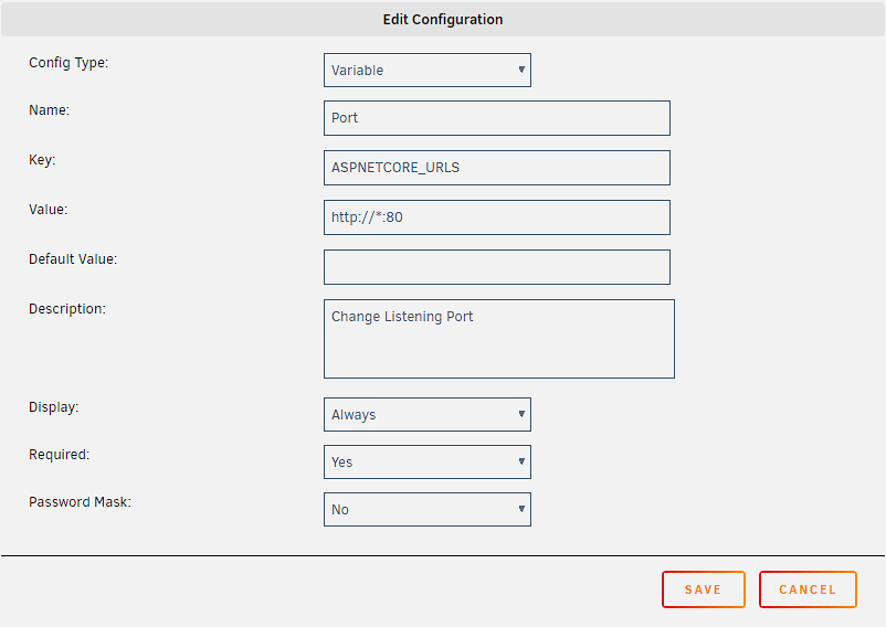

April 16, 20233 yr @Marzel Can you please change the ENV to the Unraid template instead of the image? I assign an IP address to the Docker and I would like it to listen to port 80 and not 5000. I can change it using Portainer but I have to recreate the docker and I am worried about updates... ASPNETCORE_URLS http://*:80
May 2, 20233 yr On 4/16/2023 at 5:51 PM, ceyo14 said: @Marzel Can you please change the ENV to the Unraid template instead of the image? I assign an IP address to the Docker and I would like it to listen to port 80 and not 5000. I can change it using Portainer but I have to recreate the docker and I am worried about updates... ASPNETCORE_URLS http://*:80 @Marzel So I couldn't connect to the docker and saw that it updated... this changed the port again to 5000. how can I prevent this from happening?
May 2, 20233 yr 10 minutes ago, ceyo14 said: @Marzel So I couldn't connect to the docker and saw that it updated... this changed the port again to 5000. how can I prevent this from happening? ok, I figured it out... instead of extra parameters or post arguments, you need to add a Variable... there I put the following. In case someone needs this, or me in the future.

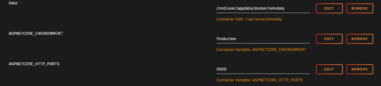

February 23, 20242 yr 6 hours ago, blaine07 said: I tried to migrate to "new" version unsuccessfully. Anyone have any advice? Not sure what I need/did wrong? https://github.com/immense/Remotely/releases/tag/v2024.02.22.1231 I just got in again by changing 3 values: Changed the "Data" path to: /var/www/remotely Added 2 variables: ASPNETCORE_ENVIRONMENT = Production ASPNETCORE_HTTP_PORTS = 5000 Should look like this: I didn't do a full test but at least I have access to the WebUI again Edited February 23, 20242 yr by Nemz

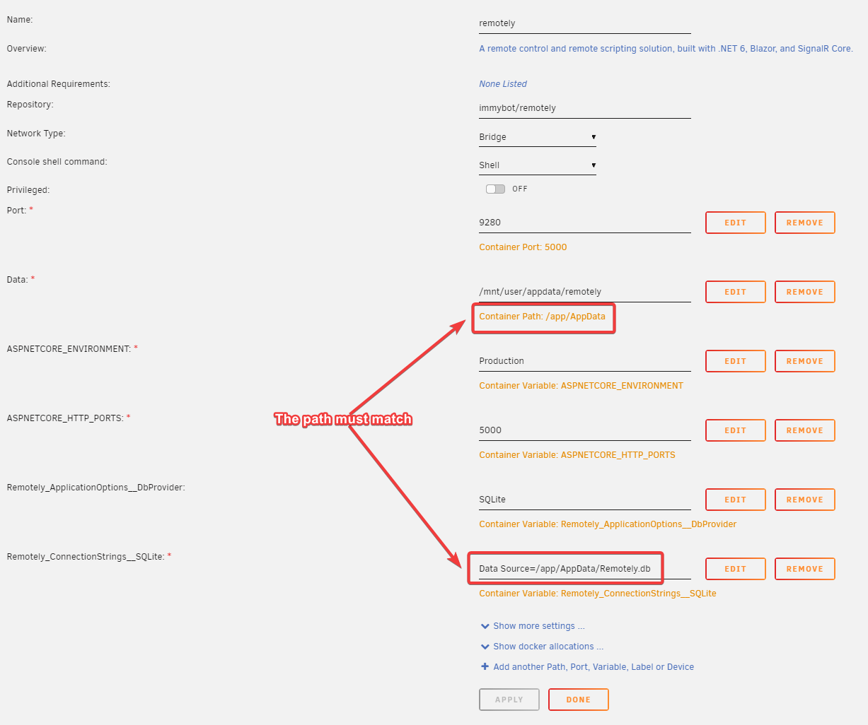

February 24, 20242 yr I've got it working completely. Here's a screenshot of the settings I've added. One thing to note is that you must specify the Sql environment variables and the path's must match that of the container path. ASPNETCORE_ENVIRONMENT=Production ASPNETCORE_HTTP_PORTS=5000 Remotely_ApplicationOptions__DbProvider=SQLite Remotely_ConnectionStrings__SQLite=Data Source=/app/AppData/Remotely.db The author also mentions "I did not test with Cloudflare Tunnels, so I'm assuming that still won't work." but it's working fine for me.

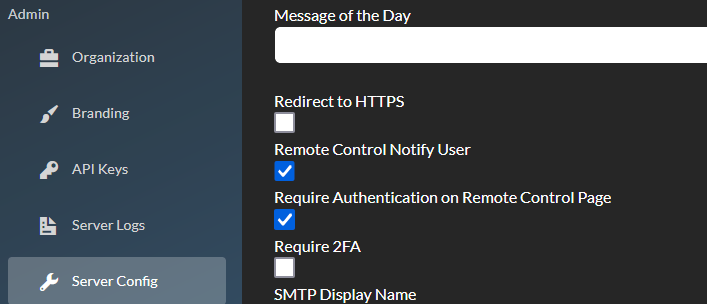

July 21, 20242 yr On 2/26/2024 at 3:35 PM, blaine07 said: Anyone have any idea what I have set wrong to see this in logs? [14:20:03 WRN] Failed to determine the https port for redirect. {EventId={Id=3, Name="FailedToDeterminePort"}, SourceContext="Microsoft.AspNetCore.HttpsPolicy.HttpsRedirectionMiddleware", RequestId="0HN1N118BKSL3:00000001", RequestPath="/", ConnectionId="0HN1N118BKSL3", ThreadId=12} Seems to be working fine for me through cloudflare tunnels though so not sure what that's about? Hi @blaine07, I'm seeing the same thing on my server. I found this article. Basically, it boils down to HTTPS upgrades/redirection. I'm using a Reverse Proxy (SWAG) and all my redirections are handled in that. The linked article then says: With that in mind, head over to your Remotely webUI, log in as admin, go to server config and find the "Redirect to HTTPS" checkbox and de-select it: With that done the message won't show up in your logs. I will note that I've run with the warning present for almost a year and saw no ill-affects. I don't think this is anything to be too worried about either way. JP
