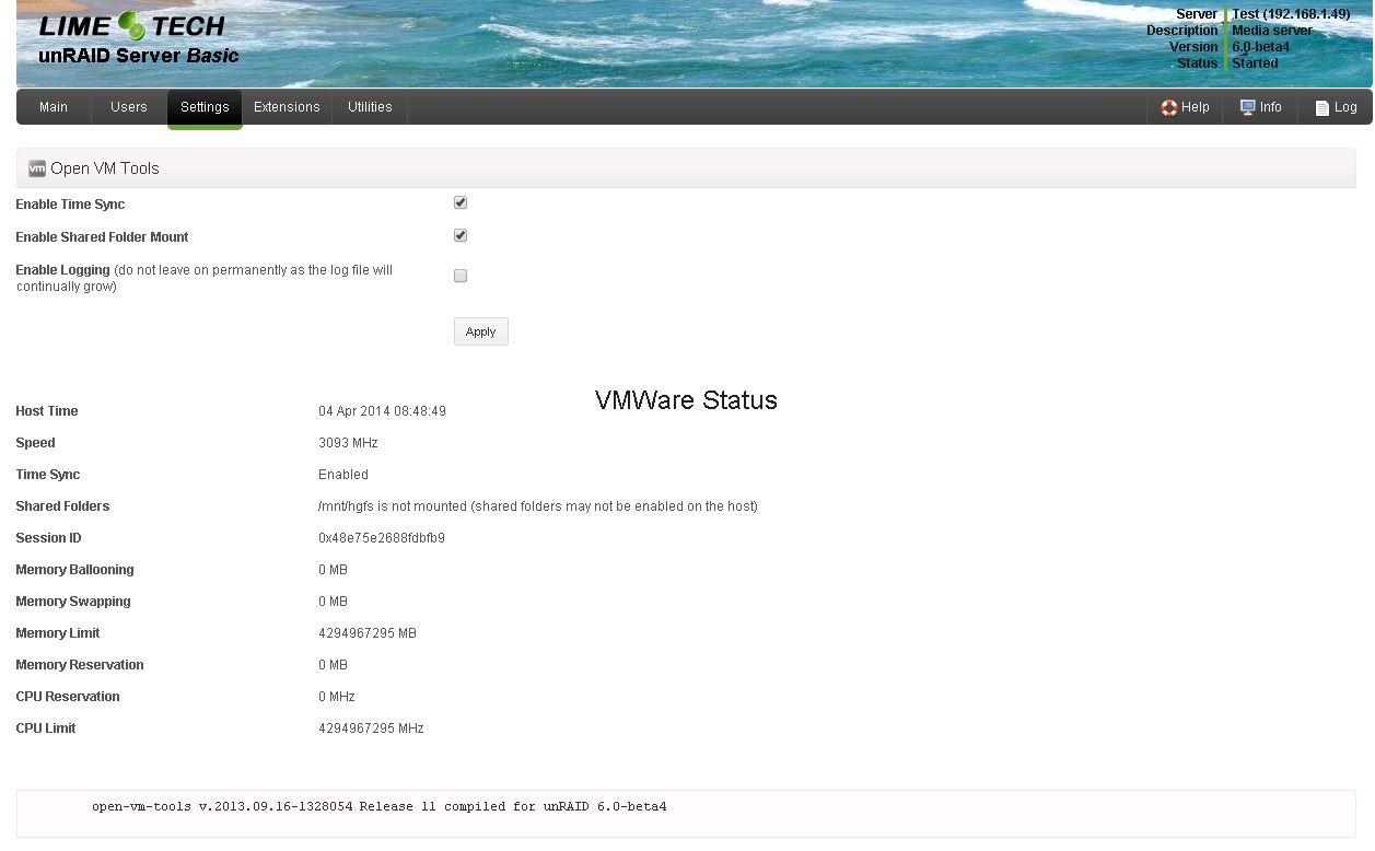

Been a little while since any update in this thread but just had to say I downloaded this version of VM Tools as I noticed my unRAID listed it not working. I am using ESXI 5.5 with unRAID 6.0b4 and now have my VMware Tools listed as running (3rd-party/independent).
Copied the link for the package and in the unRAID website went to Extensions, pasted the link and hit 'Install' and unRAID did everything it needed and saw 'Open VMware Tools' under Settings.
From my ESXI vSphere Client, I right clicked on unRAID and told it to 'Restart Guest' and it unmounted the drives, rebooted and came right back up ready to go. No need for parity check and I am using a cache drive.
Just wanted to share my success and thank Zeron for all the hard work on this plugin.
