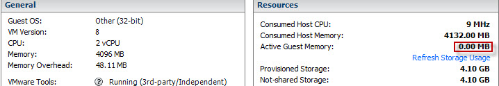

I also noticed, and maybe its an updated kernel thing, but thought I should mention should it be vmtools related and if anyone less see's this behaviour.
There are times when the vsphere client shows Zero usage of active guest memory, where in the past RC's and vmtools loaded there was at least some usage displayed never zero.
Screenshot attached to lessen any confusion of what I am referring to. THis may not be an issue but a good, thing, just not sure if an OS that's running actually is using nothing...
