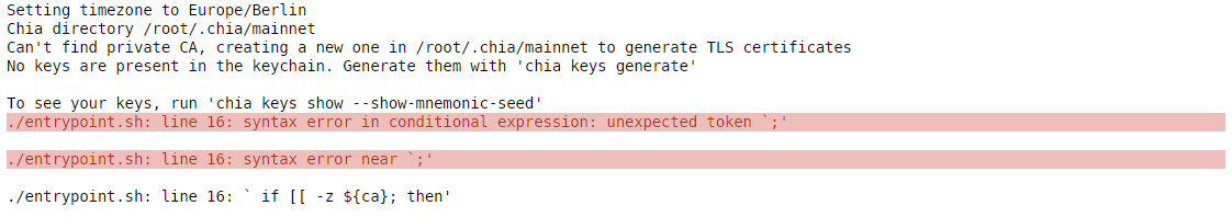

I want to run a plotter/harvester, but i cannot get it to work.
I have set farmer node to 192.168.1.24 which is my full node farmer, port to 8447 as suggested earlier, and harvester_only to true. Also i set the paths to /plot and /plotter.
The docker simply fails and stops.
The logs only show this:
Hello, Thank you for this awesome docker template.
I got the harvester only working for a day and it was connecting to the main full node ok (can see passing filter).
My initial setting was:
harvester only = true
farmer_address: XXX.XXX.XXX.XXX
farmer_port: 8447
I had to put farmer address in here, otherwise docker will fail to start, which should not be necessary.
I believe the value here changes the "full node -> farmer_peer" section, which is not needed according to
https://github.com/Chia-Network/chia-blockchain/wiki/Farming-on-many-machines
Anyway, the initial setting worked.
Then, all of a sudden, the docker might have restarted due to a parity disk problem (no change to docker settings).
appdata is on cache disk, which should not be affected.
How the docker log says: farmer address required. no matter whether I put farmer address and port here, it complaints about not having farmer address.
Chia directory /root/.chia/mainnet
No keys are present in the keychain. Generate them with 'chia keys generate'
/root/.chia/mainnet already exists, no migration action taken
to use your own keys pass them as a text file -v /path/to/keyfile:/path/in/container and -e keys="/path/in/container"
Generating private key
Added private key with public key fingerprint XXXX and mnemonic
maid omit major grace toast sock voice cruel diesel dumb weekend pumpkin asset again feel genius host syrup flower axis near advice later food
WARNING: using a farmer address which we don't have the private keys for. We searched the first 500 addresses. Consider overriding XXXX with XXXX
WARNING: using a pool address which we don't have the private keys for. We searched the first 500 addresses. Consider overriding XXXX with XXXX
Added plot directory "/plots".
A farmer peer address, port, and ca path are required.

i Get the same error... and then the docker stops.. what changed in this last update?
have been running this chia docker as harvester only for many days...
https://forums.unraid.net/profile/119008-partition-pixel/
Took me an hour and got it working.
I would suggest to put it in the docker template.
Looking at here https://github.com/Chia-Network/chia-docker/blob/main/entrypoint.sh
line 40
echo "A farmer peer address, port, and ca path are required."
The docker needs a variable called ca
So I added a variable for the docker (called Key below) called ca
to add: press "Add another Path, Port, Variable, Label or Device"
Config Type:Variable
Key:ca
Value:/config/ssl/ca/
Make sure you also put these in (which should not be needed according to config.yaml in the original post "Farming on many machines"
farmer_address: YOUR.FARMER.IP
farmer_port: 8447
Edited by jena
Key:ca
farmer_port: 8447
Thank you, this did it for me.
