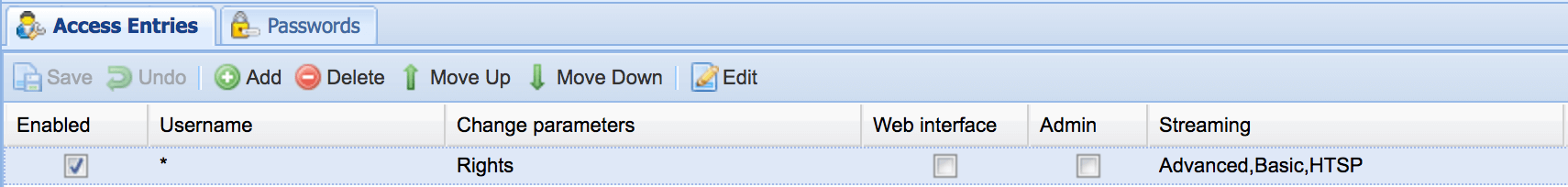

To be able to stream from Tvheadend, you need to set up an anonymous user in Tvheadend that has streaming rights. You can do this in the users section, by creating a user *:

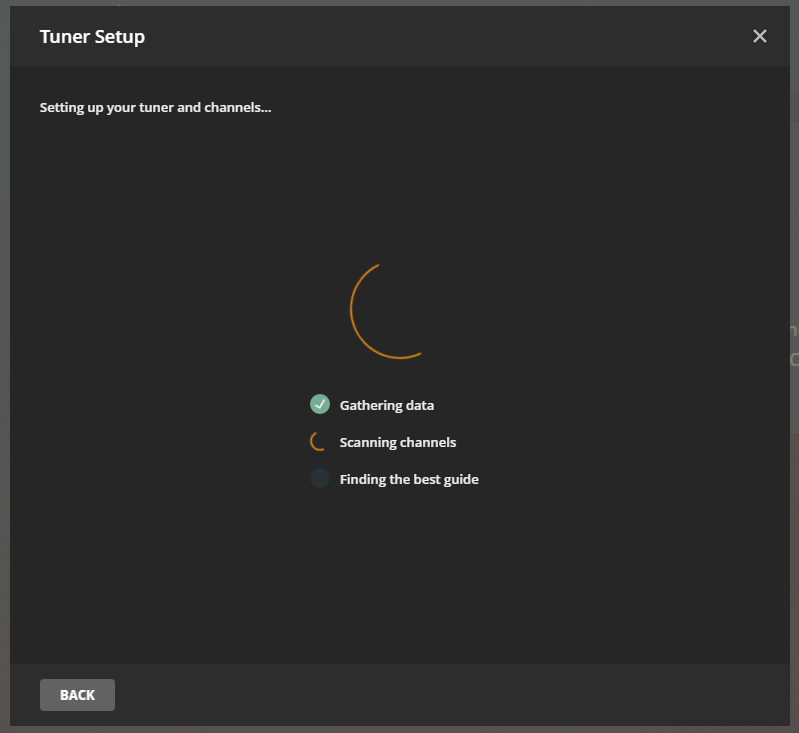

I was able to get Plex to recognize Antennas, but it will not find any channels.  Any ideas on what I might be missing?
Edited by scbuckeye75
Add image
How long have you waiting? it takes a long time till channels are listed
25 minutes and still the same.
It can take more than 1 hour....
Alright, I'll give it some more time.

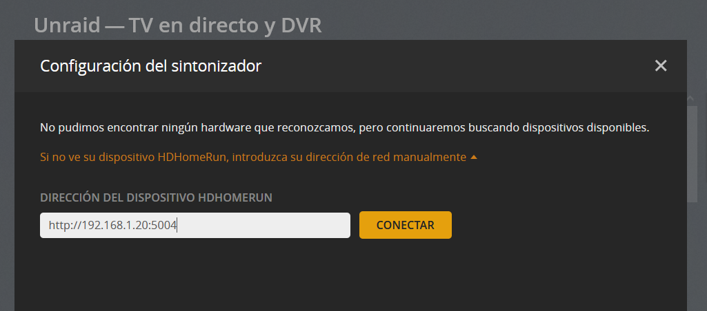

hi all, maybe a stupid question. But how can i connect (manually, without discover?) the antennas docker with plex?
My antennas should work fine in my docker container but plex can't find it as a device.
Regarding the official documentation plex cant discover antennas from a docker container.
Another way to get it running is to run it using Docker. Note that some functionality is currently not quite working when hosting this as a Docker container, namely, discovery from Plex. But with that warning, if you so choose to continue using Docker, the instructions are below.
You just need to copy the "URL for Antennas" link into plex manual config and then click connect:

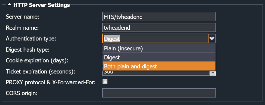

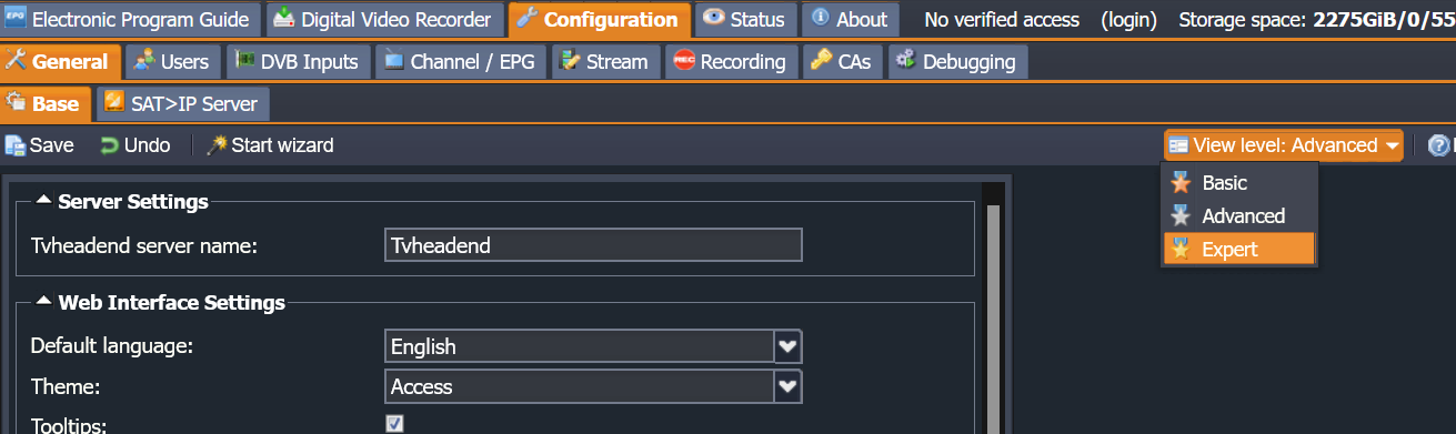

You have to change the auth mode to "Both plain and digest" under Configuration > General > Base switching to expert mode:
I opened an issue related to this:
https://github.com/jfarseneau/antennas/issues/85
Edited by yayitazale
Thank you so much, got it working again now. Had to remove the user:pass from the tvheadend address in config as well but all seems to be working now.
