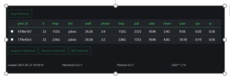

19 minutes ago, guy.davis said:
Yup, that sounds good.  With a 350 GB sized cache pool, you'll probably get one plot at a time, so you may need to decrease the default plotman.yaml settings.  You'll know if the temp cache drive hits 100% and your plotting gets hung.
Thanks !  Can I just change that while the docker is running ?
It kind of looks like the process has halted ?
Yes, those phase 3 are some of the biggest.  Double-check your temp drive is at 100% full to be sure.  If not, leave it running.
But if 100% full, then leave the Machinaris container running but:
  1. Stop Plotman -> This prevents another plot from being started.
  2. Select both plots and 'Kill Selected' -> This stops both plots and cleans up all temp they were using.
  3. Check your temp drive, should be empty again.
  4. Go to Settings | Plotting and look for tmpdir_max_jobs and global_max_jobs.  I'd dial them both down from 2 to 1 with a 350 GB temp space.  Save the changes.
  5. Start Plotman on Plotting page.  Should immediately see one plot at a time going.
Hope this helps.

Its still just sitting there…. Cache drive has more then enough free… 100g+ ..
I removed the plots and restarted the process with 1 plot at a time.. I had been fiddling with the type of cache drive (Only, Prefered). I can imagine that had created some conflicting data.. Since this morning it is tugging along at its first plot and now sitting at 3:4 but still running.. So I am guessing all is fine now !

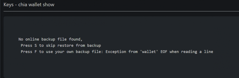

Can anyone tell me why i see this and how to resolve it?
Someone posted the answer on the last page. Connect via console.

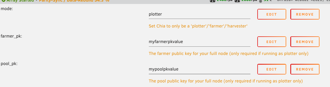

To run this in Plotter mode only, are these the correct changes (variables added) that need to be made to the docker (See attached image). Is there any other changes required?
Also, do we need to remove the mnemonic.txt file from the chia root folder?
Thanks!
Thanks!
Good question, I've been plotting on windows machines with 'mode=plotter' and  'keys=/root/.chia/mnemonic.txt' just like the other modes.  I know that works.
However, it's best practice to not put private key mnemonic on a plotting only machine.  So in test version (ghcr.io/guydavis/machinaris:test), there is support for not putting mnemonic.txt file down, but rather using farmer_pk and pool_pk.
Above looks good.  If it works, you'll see that on start-up, Settings | Plotting should already have your farmer_pk and pool_pk at the bottom of the plotman.yaml file.
Any problems, please create an issue in Github.  Also, feel free to join the Discord group for live support.

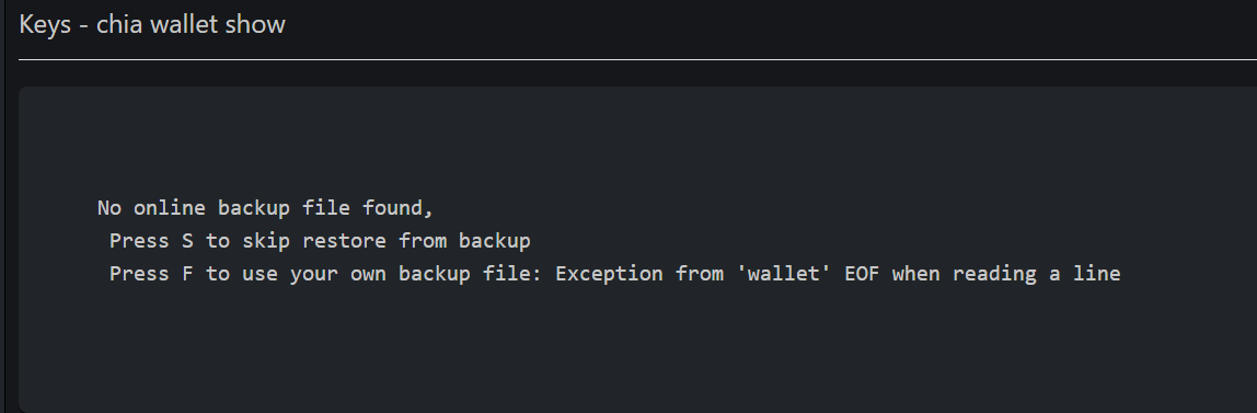

Hi -  I generated a key when I installed this,then deleted the mnemonic.txt, then I copied my own mnemonic.txt - now it shows I have 2 wallets (I only want one).  In the wallet section, it looks like a console prompt  but keys will not respond eg 1/2/q within the web page to select or quit- anyone know how to fix please?
Thanks

1 hour ago, shimlapinks said:
Hi -  I generated a key when I installed this,then deleted the mnemonic.txt, then I copied my own mnemonic.txt - now it shows I have 2 wallets (I only want one).  In the wallet section, it looks like a console prompt below but keys will not respond eg 1/2/q within the web page to select or quit- anyone know how to fix please?
Thanks
Figured it out
To fix, I just deleted one of the empty wallets via the console
wallet says not in sync now but hopefuly that will iron itself out.
