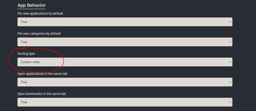

December 28, 20214 yr Hello. What value should i enter in "useOrdering":"createdAt" so i can reorder the apps manually? Right now when i try to reorder the apps i get this: Error Custom order is disabled I tried "custom" and "manual" but when i change the value to this the apps and bookmarks show a loading animation forever. Looking forward to your answer
December 28, 20214 yr Author 9 minutes ago, Alfy1080 said: Hello. What value should i enter in "useOrdering":"createdAt" so i can reorder the apps manually? It should be set to "Custom order": If for some reason you are editing your config file manually, it should be set to: "useOrdering":"orderId"
December 28, 20214 yr Thanks for the quick reply. For some reason i didn't think to look under the interface menu for that setting so i was trying to edit that in the config. I changed the setting and it's working. Thanks for the help!
