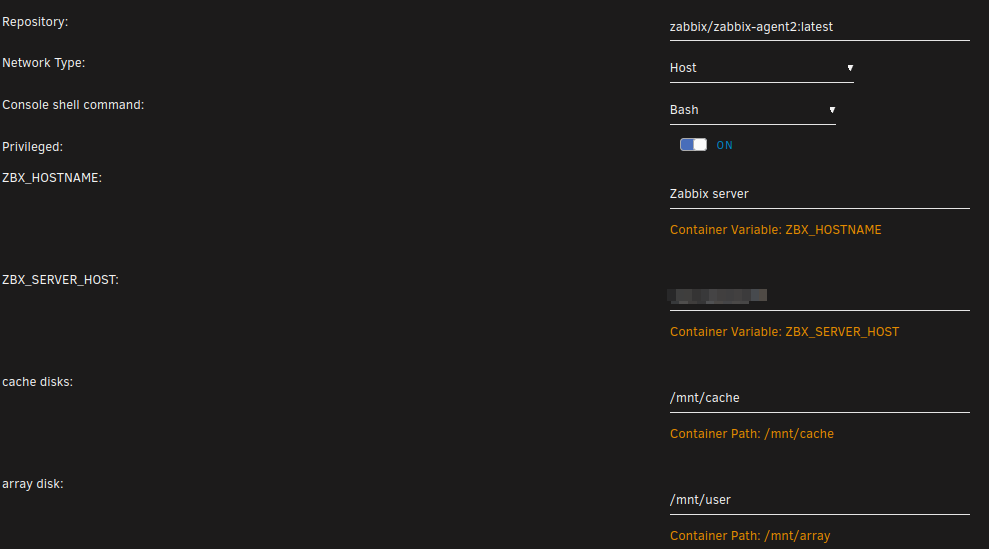

  • Privileged mode does need to be left as enabled. This allows the agent to see system resources
  • Adding Disks for Monitoring:
    On the docker configuration page you will preconfigured /mnt/user and /mnt/cache (as array and cache pool). You can change it on Your own, for example by disk or maybe add some other pools.
    Access Mode can be just Read Only
Note, In Zabbix WebGUI You must set disk monitoring like Container Paths.

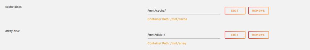

Above you mentioned "Note, In Zabbix WebGUI You must set disk monitoring like Container Paths.", can you please elaborate a little bit on this last part?
Sorry, I think I missed notification about reply.
On the docker configuration page you have preconfigured /mnt/user and /mnt/cache (as array and cache pool).
For example:
/mnt/user on host You can bind to /mnt/array in zabbix agent container
/mnt/cache on host You can bind to /mnt/something in zabbix agent container
In Zabbix GUI You must set container paths to monitor, so:
/mnt/array
and
/mnt/something
