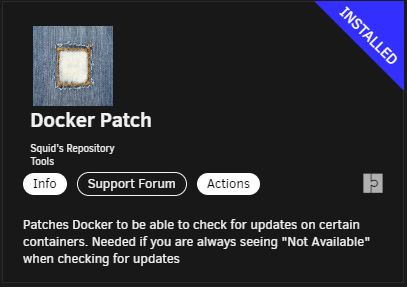

11 minutes ago, TimTheSettler said:
Just a note that the app has the same problem on a different server in a different location.
So this is AFTER applying the docker update patch and rebooting?
Sorry, I'm not sure which "docker update patch" you're referring to.  All plugins on this server are up-to-date and I'm running Unraid 6.11.5 as noted in my signature below.  Server was last rebooted three weeks ago.
Exactly the same for me
@JonathanM I found the Docker Patch plug-in and installed it.  That fixed my problem.  Thanks.  But I have to say that this was not easy to find.  What I mean is that I searched a lot and read a lot of posts about the "not available" and couldn't easily find this Docker Patch thing.  I'll update the threads that I read through to point to the patch.
Look for this in the apps and install it.  It will fix your problem.  No need to reboot.
Edited by TimTheSettler
