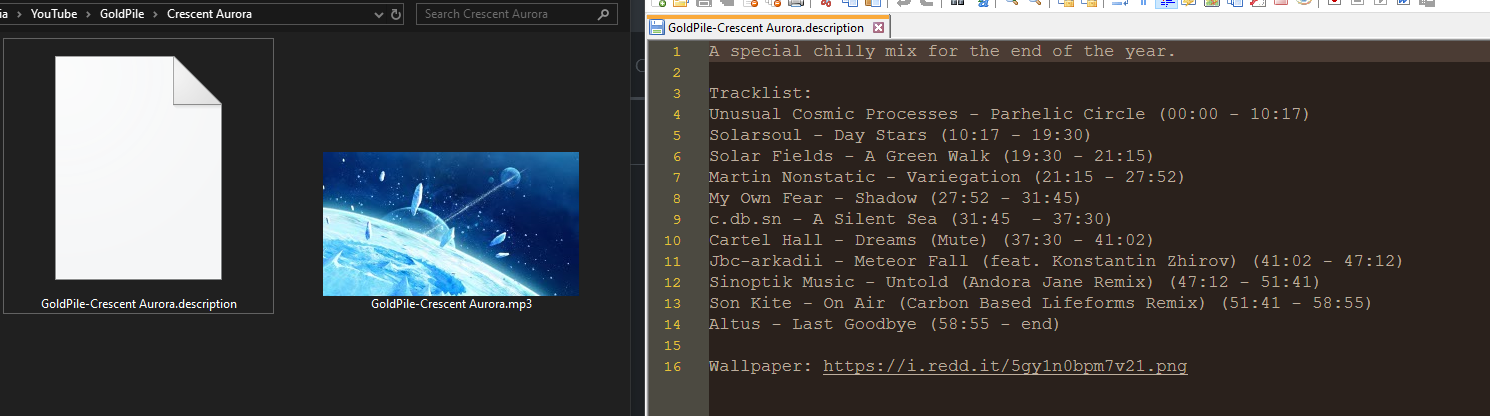

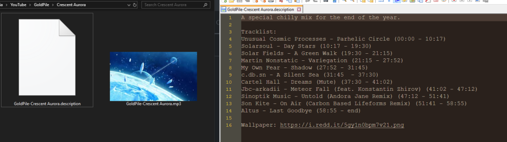

10 hours ago, Construc_ said:
is there a way to specify additional download parameters, such as:
--write-description
the output template is great, but doesn't quite let me do that^, thanks.
the description contains the links to the artists/songs, etc. and this would help greatly 🙏
All the available options are described here : https://github.com/yt-dlp/yt-dlp/blob/master/yt_dlp/YoutubeDL.py#L183
There is indeed this option:
writedescription:       Write the video description to a .description file
The format to use in the docker container template would be to add the following in the "options" field (i.e.: the "Container Variable: YTDL_OPTIONS" variable):
"writedescription": true
Edited by Opawesome
Fix wrong link to available options
3 hours ago, Opawesome said:
All the available options are described here : https://github.com/yt-dlp/yt-dlp?tab=readme-ov-file#usage-and-options

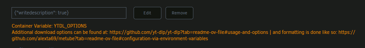

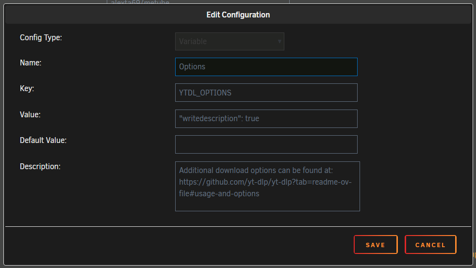

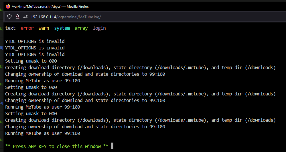

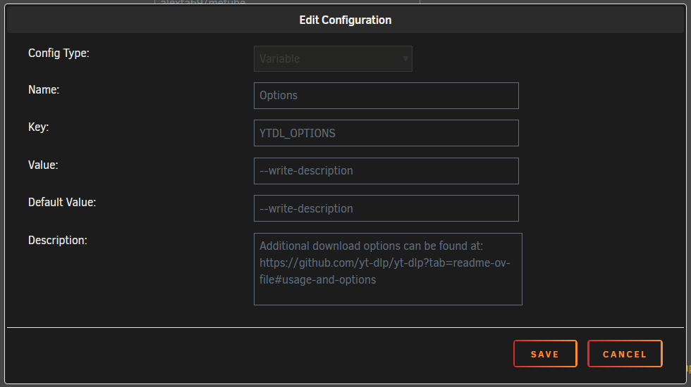

image.png.43a3f8e10bcb206ea7718dae3d3d77a1.pngi have no idea what im doing but i dont think im doing it correctly? im not entirely sure what you meant by `in the "options" field (i.e.: the "Container Variable: YTDL_OPTIONS" variable`, sorry.
i added a variable to the docker container, set its key to `YTDL_OPTIONS`, and tried both `"writedescription": true` and `--write-description` in the value field, to no effect.
where would i go to see what kinds of variables the docker container has? if thats where i should be looking for answers, thanks 🙏
You are in the right place 😀. I just think your syntax is wrong. You should probably set the value to:
{"writedescription": true}
to respect the JSON format requirement (I assumed you had already some options set up with the right format). See https://github.com/alexta69/metube?tab=readme-ov-file#configuration-via-environment-variables for the details.
It says:
YTDL_OPTIONS: Additional options to pass to youtube-dl, in JSON format. See available options here. They roughly correspond to command-line options, though some do not have exact equivalents here, for example --recode-video has to be specified via postprocessors. Also note that dashes are replaced with underscores. [...]
The following example value for YTDL_OPTIONS embeds English subtitles and chapter markers (for videos that have them), and also changes the permissions on the downloaded video and sets the file modification timestamp to the date of when it was downloaded:
environment: - 'YTDL_OPTIONS={"writesubtitles":true,"subtitleslangs":["en","-live_chat"],"updatetime":false,"postprocessors":[{"key":"Exec","exec_cmd":"chmod 0664","when":"after_move"},{"key":"FFmpegEmbedSubtitle","already_have_subtitle":false},{"key":"FFmpegMetadata","add_chapters":true}]}'
Edited by Opawesome
that worked perfectly! thanks so much 🙌image.thumb.png.562f4c40b5412d0280244d1f7e538dad.png

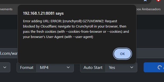

after the last update, i can't download from crunchyroll what is the problem ?
Edited by Azozo
