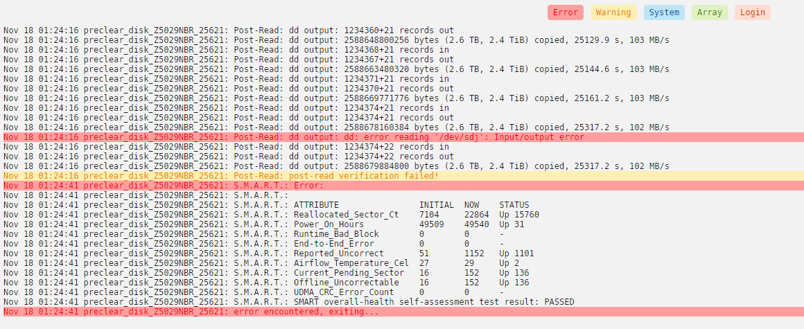

I noticed that the system was responding very sluggishly for some reason so I had a quick look, and disk 8 was showing offline. I stopped the array, removed the drive from the array, started array, stopped array, re-assigned, started, and waited for rebuild. Everything seemed fine. Then the next day, the same thing happened.
This is where I screwed up. I completely removed the drive and attempted to pre-clear it (data wasn't super important). Left it for about 30 hours, and came back to a message of "Error encountered, please verify the log".
I now have a replacement drive, which I will be installing now, but I've got a few of these drives that seem to fail and i'm not knowledgeable enough to understand if they are actually dead. I've tried reading through the "Understanding SMART Reports" article but I'm just not smart enough to get it.

drive Z5029NBR has only a very old SMART test but the attributes do not look good (in particular #197 & 198 but also #5):

You could try to run an extended SMART test, but don't get your hopes up.
Regarding what happened, not sure myself, maybe another user with more knowledge can chime in.
I'd guess that it is just an old drive ? (+49500 of power ON hours)
17 minutes ago, Netbug said:
1. Is there any way to know, from the logs and information, what happened?
Disk has pending sectors, it needs to be replaced, on other disks you can run an extended SMART test to confirm if they are OK or not.

For #198 the only acceptable should be 0;
For #197, it should not stay above 0 for too long. The should go from Pending to Reallocated (#5), but there is only a limited amount of reserve sectors the drive can use.
1 hour ago, Netbug said:
I'll have to dig in to what Current_Pending_Sector and Offline_Uncorrectable mean and what thresholds are acceptable.
The thresholds in SMART is when the manufacturer outright states that the drive is failing.  However, they tend to be very skewed towards the manufacturer's best interests on some attributes.
In particular attribute 5 the value vs the threshold shows that the drive is no where near failing.  However 23000 reallocated sectors already (and more coming) shows that the drive is basically toast.  Many users think that a single reallocated sector is grounds to replace a drive.  I can deal with ~100 before I start to get worried.  Over a hundred and I'll order a new drive online.  At 23000, I'd be going to the nearest brick and mortar store.
