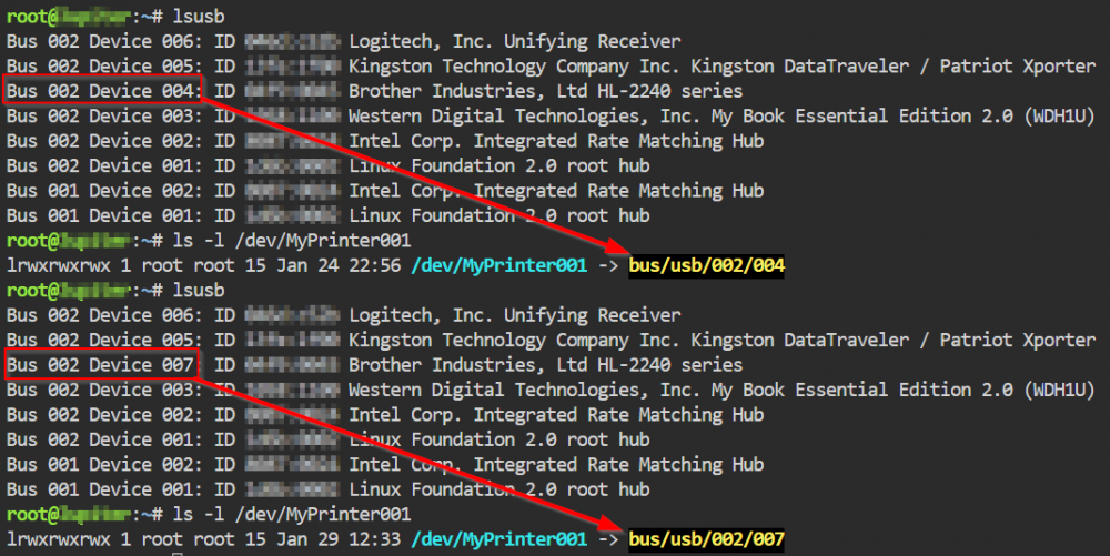

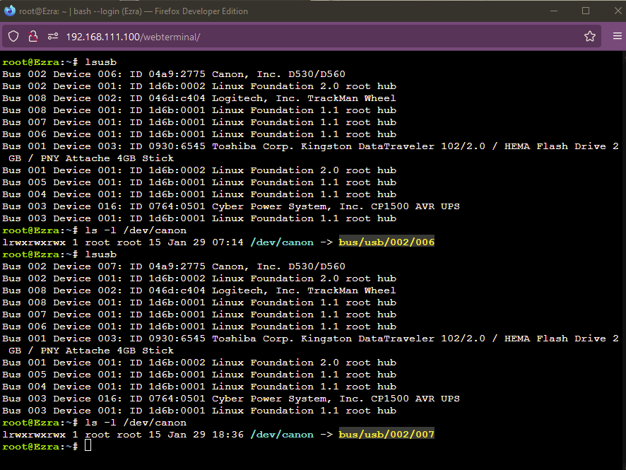

Fix for the USB device path changing all the time. No privileged flag needed, here are the directions in case anyone needs it:
The Problem
CUPS maps to a specific USB device path like /dev/bus/usb/003/023 which changes on every reboot, causing the printer to disappear.
The Solution
Create a persistent udev symlink for the printer, then map both the symlink and the USB bus into the container.
Step 1 — Find Your Printer's USB IDs
In the Unraid terminal run:
bash
lsusb
Look for your printer in the output, e.g.:
Bus 003 Device 023: ID 03f0:052a HP, Inc LaserJet M1212nf MFP
Note the two values after ID — 03f0 is the vendor ID, 052a is the product ID.
Step 2 — Create the udev Rule
bash
nano /etc/udev/rules.d/99-usb-printer.rules
Paste this (substituting your own vendor/product IDs):
SUBSYSTEM=="usb", ATTRS{idVendor}=="03f0", ATTRS{idProduct}=="052a", SYMLINK+="usb_printer", MODE="0666"
  • Ctrl+O → save
  • Enter → confirm
  • Ctrl+X → exit
Step 3 — Reload udev and Trigger It
bash
udevadm control --reload-rules && udevadm trigger
Verify the symlink was created:
bash
ls -la /dev/usb_printer
You should see something like:
lrwxrwxrwx 1 root root ... /dev/usb_printer -> bus/usb/003/023
Step 4 — Update CUPS Container in Unraid
In the Unraid Docker tab, click Edit on your CUPS container. Remove any existing USB device mapping (the one pointing to a specific /dev/bus/usb/00x/00x path), then add these two entries:
Entry 1 — Device mapping:
Field
Value
Config Type
Device
Name
USB Printer
Value
/dev/usb_printer
Entry 2 — Path mapping:
Field
Value
Config Type
Path
Name
USB Bus
Container Path
/dev/bus/usb
Host Path
/dev/bus/usb
Access Mode
Read/Write
Default Value
(leave blank)
Click Apply and let the container restart.
Step 5 — Verify
Open the CUPS web UI at http://[unraid-ip]:631, go to Printers → your printer → dropdown → Print Test Page. The job should process and print successfully.
