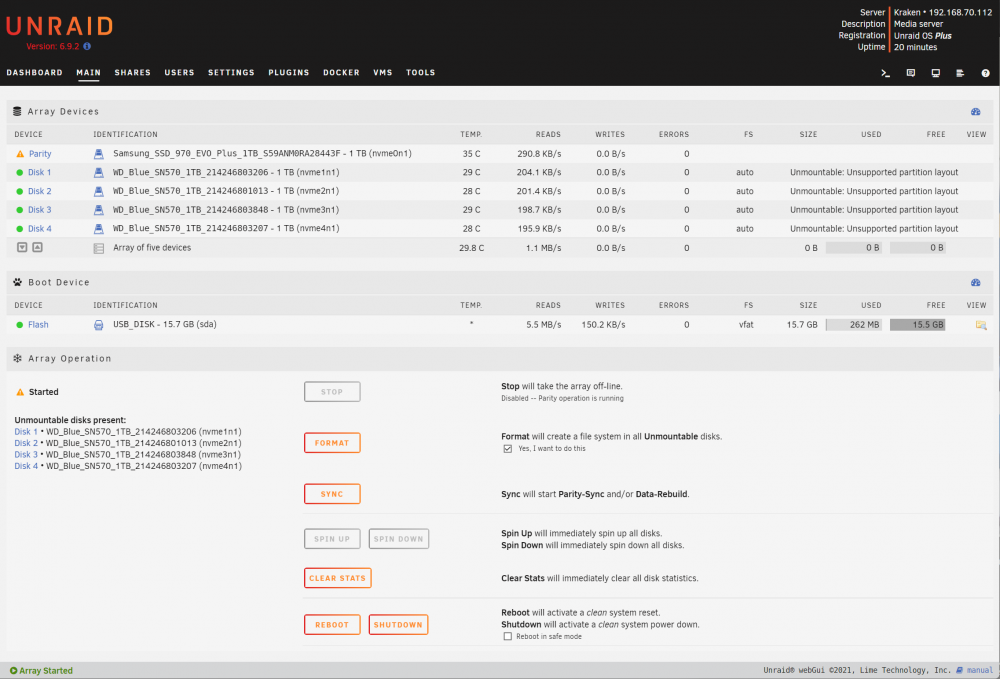

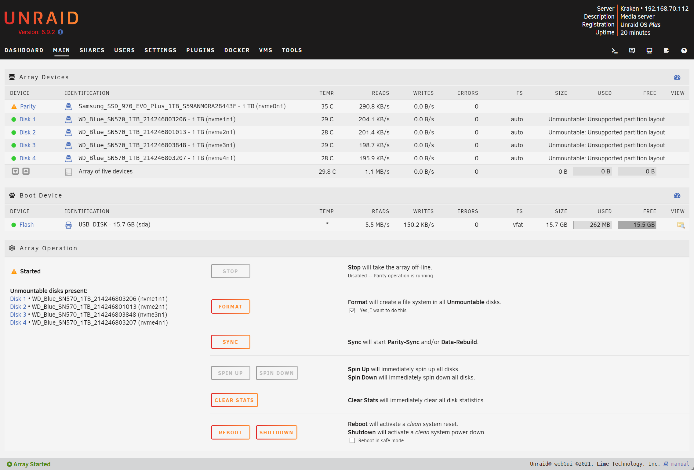

February 5, 20224 yr Author So now I started the array and it didn't immediately take the server offline. However it told me that the disks were unmountable. I checked the box to enable formatting and clicked format (I probably should have waited until parity synced) but now the page is taking too long to respond again. I can still see the server on the network this time so it hasn't shut down. But I am again unable to visit the web console as intended. Should I give it a few hours to see if the parity works this time? The keyboard/monitor is also unresponsive again so I can't even run diagnostics. (blinking cursor but accepts no input)
February 5, 20224 yr 3 minutes ago, ehosinski said: However it told me that the disks were unmountable This is expected if the drives have not previously been formatted by Unraid. 4 minutes ago, ehosinski said: I checked the box to enable formatting and clicked format (I probably should have waited until parity synced) but now the page is taking too long to respond again. This could take quite a long time to complete if you are simultaneously building parity. If not done at the same time it is normally quite quick. As the server is still operational you may find that if you close the browser and then connect s second time then you get something useful. If not then wait until parity is built.
