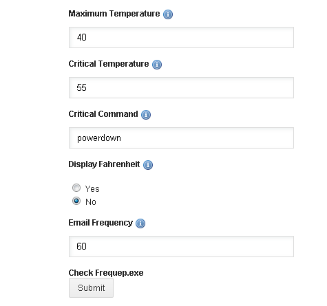

I have been running Simple Features for a month or so along with 5b12a.  I have to say I love the style of this skin/plugin.  Unfortunately I finally got around to configuring the mail notify script.  I had everything working for a while. I was getting regular hourly updates which was great.  Yet when I'm trying to sleep and both of my iPhones and my iPad are buzzing to let me know I have email i decided to adjust the notification.  Well somehow in my move to change the email frequency I caused all emails to stop.  If I hit "Send Test" it works every time, but the default timer to email me doesn't work.  Also below my email frequency box and just above the submit button I have the words Check  Frequep.exe. I have no idea what this means but after many googles and unraid forum searches I am still at a loss.  Any thoughts?
Hmm, I haven't actually tested the notification frequency  :o    I tend to have the script send me notifications on failure only.
You can move the /flash/config/email folder elsewhere and reboot. It'll re-create the default settings again, see if it does it then.

I will give that a shot when I get home from work thanks.

Removing the Email folder in Boot/Config/ seems to have worked perfectly.  It gave me back several options from the Email page settings that I hadn't even realized had gone missing.  Thanks again.
