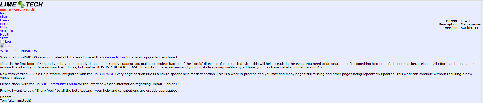

I just built my unRAID server and installed SimpleFeatures but it is not looking at all like the pictures.
Contents of my "go" file:

Obviously, the file exists at the specified location. Here is a screenshot of what my UI looks like.
Let me know if you need anything else. Thanks

Delete the file "/boot/config/ultra.cfg" and re-install the package. See if that brings an improvement.
Clear the cache of your browser and reload the page, that should do the trick...
Not for me  ;)
That worked for me. Thanks a lot.

For me is this the issue....  ;)  see attached image. And I have cleared the cache several times.
//Peter
What does your /boot/config/go file look like? And where did you copy the tgz file to on the flash drive?
Here is the what my go file looks like:
#!/bin/bash
# Start the Management Utility
/usr/local/sbin/emhttp &
installpkg /boot/packages/simpleFeatures-0.9b-unraid-speeding_ant.tgz
installpkg /boot/packages/simpleFeatures-0.9g-unraid-adapted-by-bergware.tgz
/boot/unmenu/uu
cd /boot/packages && find . -name '*.auto_install' -type f -print | sort | xargs -n1 sh -c
unraid_notify start
The .tgz file is in the packages folder.  I had originally put the 'simpleFeatures-0.9g-unraid-adapted-by-bergware.tgz' file in the extras folder but things were not working correctly.  I then moved it to the packages folder and added the line to install the package to the go file using the 'config view/edit option  in unMenu.
Use one or the other of the SimpleFeatures packages but not both, they are not meant to complement each other.
