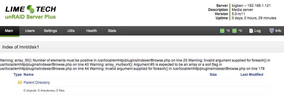

When trying to browse the contents of a recently formatted/empty disk I get the following error in Browse.php (see image).
Here's a simple patch to fix this problem with minimal formatting changes:
--- Browse.php.orig	2013-02-19 19:15:06.000000000 -0500
+++ Browse.php	2013-02-19 19:16:50.000000000 -0500
@@ -22,7 +22,7 @@
   $i = 0;
   exec("stat -L -c'%F|%n|%s|%Y' $path", &$file);
   if ($show_disk) exec("/usr/local/sbin/stat_ino -l $path", &$disk);
-  else $disk = array_fill(0, count($file), '');
+  else if (!empty($file)) { $disk = array_fill(0, count($file), '');
   foreach ($file as $entry) {
     $attr = explode('|', $entry);
     $list[] = array(
@@ -55,7 +55,7 @@
       array_multisort($type,$opt, $indx,$opt,SORT_NUMERIC, $name,$opt, $list);
     else
      array_multisort($type,$opt, $indx,$opt, $name,$opt, $list);
// return sorted list
   return $list;
@@ -175,6 +175,7 @@
<?endif;?>
   </tr>
<?$dirs=0; $files=0; $total=0;
+  if (!empty($list)):
   foreach ($list as $entry):
?>  <tr>
<?  if ($entry['type']=='directory'):
@@ -199,6 +200,7 @@
   endif;?>
     </tr>
<?endforeach;
+  endif;
   $objs = $dirs + $files;
   $objtext = ($objs == 1)? "1 object" : "{$objs} objects";
   $dirtext = ($dirs == 1)? "1 directory" : "{$dirs} directories";
