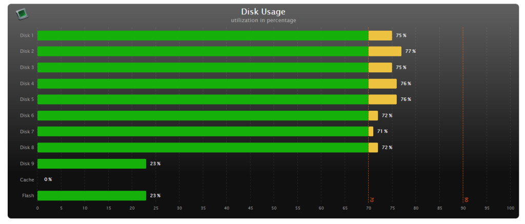

I like the new disk stats page, but i'd like to suggest that the percentages be placed on the right side of the bars instead of all on the left.  As it is now, I have a couple of disks with 99% usage, but that number sits on the green portion of the bar, so visually, I think "okay" since it's on the green.  Of course that's incorrect, but having the number on the color that actually applies seems more 'intuitive' to me.
Also, the 70% and the 90% orange dotted lines are nice, but the 70% and 90% in orange sit right on top of the white numbers right below them.  Maybe the white numbers should just be orange, and the currently orange numbers, which are turned 90 degrees can be eliminated (no sense in having the 2 numbers so close together).
Not complaints, just some suggestions to consider.  i appreciate all that you do for us!
The usage of the colors should give you an immediate indication. Yellow and red are used in the "warning" and "critical" zone.
There is a new setting in stats to put the display of the percentage value left or right. The "right" alignment however puts the number after the bar, this won't work well when disks are 99% full.
I strongly recommend you move data around, there is a performance impact with reiserfs when disks are nearly full.
Somehow your display got mixed up. Normally the orange numbers are inside the graph while the white numbers are below the graph. What screen resolution are you using?
It seems the default is set for 'right' alignment, but I'm still seeing all numbers on the left, no matter how full any individual disk is.  however, as i said before, and you also said, the red and yellow are pretty clear indications of a problem.  I only suggested putting the numbers on the right, over the red/yellow color to make it even more clear.
You said that it should put the numbers after the bars, but if it put them inside the bars that would do what I was suggesting, not a big deal though, either way.
Yeah, I'm working on getting a couple of new disks cleared, but they seem to have some issues, and it seems like I'm going to have to buy a new disk instead; good times :(
Actually, they do display they way you indicate, but the numbers are so close that I just thought it might be better to only use one of them, instead of having the 2 numbers almost on top of each other.  Probably not worth changing, I just thought I'd mention it as being 'less than ideal', but again, not a big deal.

I see in the new version of SF that the main screen also shows any disks present that are NOT part of the array.  However the disk Health screen only shows those that ARE part of the array.  Would it not be a good idea to also be able to get the Health of any disks that are NOT yet part of the array?
+1  :)
