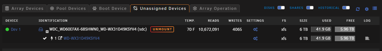

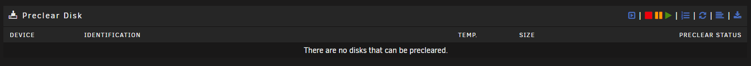

When I run the plugin from the Tools screen I get a message that says "There are no disks that can be precleared.".  But, I have a mounted disc in the unassigned Devices screen.
When I look at the unassigned devices screen I don't see an icon for the preclear.
I've tried the plugin with the drive mounted & unmounted.  Not sure what I'm missing.
Update:  And I found my own answer.  I had to delete the partition first.

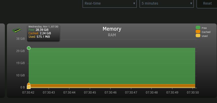

So I ran a memory test on both the old memory I was using and the new memory I just installed during the switchover (back) to an Intel setup.  All momory checked out fine; no errors.
But on the "new" setup, once I got everything up and running I attempted to preclear some discs.  Four discs to be exact.  They all failed and produced the same low memory error.  So I'm now using a new mobo, new processor, and new memory and am still getting the same error.  Also, during these new attempts to preclear, I stopped all dockers and VMs and shut down both services.  As you can see in the stats screenshot the system has plenty of available memory.
I'm at a loss.
Edited by jimeez
