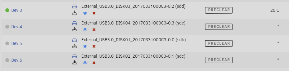

Hi Guys
Very new to unraid and trying to get my discs precleared before adding them to my array. (I aplogise, I have not read all 19 pages of this thread).
I have managed to install the plugin and I have discovered the destructive mode setting that I have enabled. I am not able to delete the partitions on my discs though. I click the red x on either the disc or the partition, I then click the clean button and nothing happens. The dialog stays there and nothing changes...
I have tried this on 3 identical discs and 1 different disc and I get the same behavior.
Is this user error or something else?
I am on unraid 6.12.3
Thanks

Hey
I am trying to preclear 4 HDDs at the same time.
After starting the preclear process for drive 1, unraid removes the preclear button next to ALL 4 HDDs and adds the "Preview Progress" button next to them (see image). Why is this happening?
Kind regards
Dustin
Ok the "problem" here was the external USB Dock (ORICO Tool-Free 5 Bay).
When connecting them all via SATA they can be individually pre-cleared.
Is there a way to support USB Docks?
Probably something to do with the identification of the drive?
Edited by Maertuerer
I believe it is dock dependent.     If you have a dock that passes through the drive serial number unaltered then it works just as well as SATA (albeit a bit slower).
Yeah the dock just needs to be transparent, but a lot aren't and it's never something you can know from the specs...
