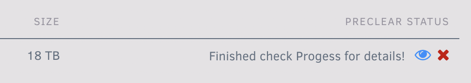

I tried to preclear using the binhex docker as suggested, and it precleared successfully. 1955386023_CleanShot2023-06-01at11_16.33@2x.png.0b641911272eae44a1df776259db459f.png
So maybe there is some bug with the plugin..? Should I stop preclear and Verify Disk using this plugin, or is the drive good to go now?
There have been several reports of post read issues on larger disks.  I haven't been able to get enough information to figure out what this might be.  That's why I suggested using the docker for your preclear.
The disk should be good to go.
Thanks for confirming! Hopefully my logs were helpful in helping you figure it out..
