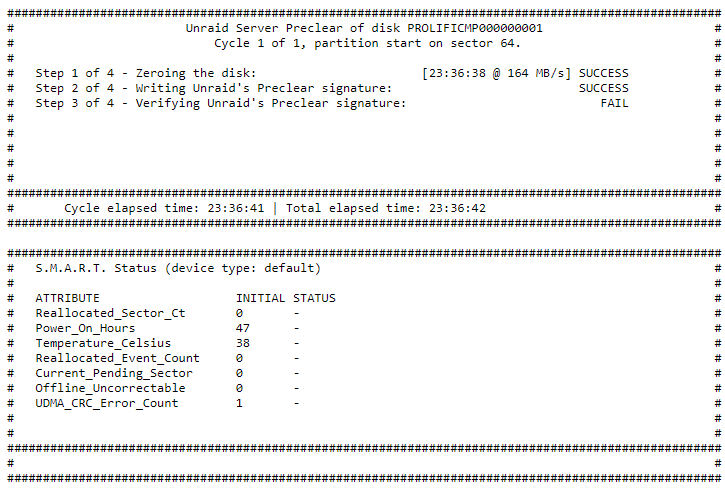

I'm having some issues with preclearing a new drive that I purchased. Every time I try to preclear it always fails at the last step in verifying Unraid's signature. I'm running on the latest version of the plugin. Is my drive bad?
Running on Unraid version 6.11.5
Unassigned Devices Preclear version 2023.01.08

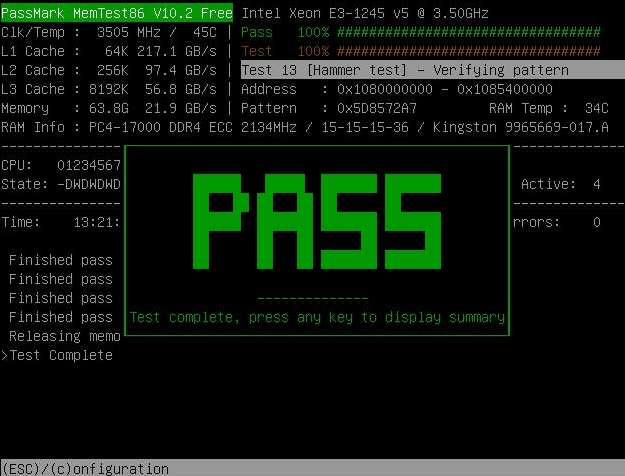

Did you also let it do post-read verification? Doesn't look like it from the log, though I haven't precleared a disk in a long time.
The reason I ask is post-read failure can be an indication of bad RAM, since bad RAM can result in the data being changed from zero either when being written or when being read. Possibly bad RAM could have a similar effect on signature verification.
Yes I had post-read verification on but because it failed at the verifying Unraid's Signature stage it never got to the last stage.
Have you done memtest recently?
I did memtest maybe 1 year ago when I upgrade my RAM. Ran it for 48hours without any issues. I'm using a external HDD docking station plugged into my server via USB to do the preclear. Do you think that might be the reason?

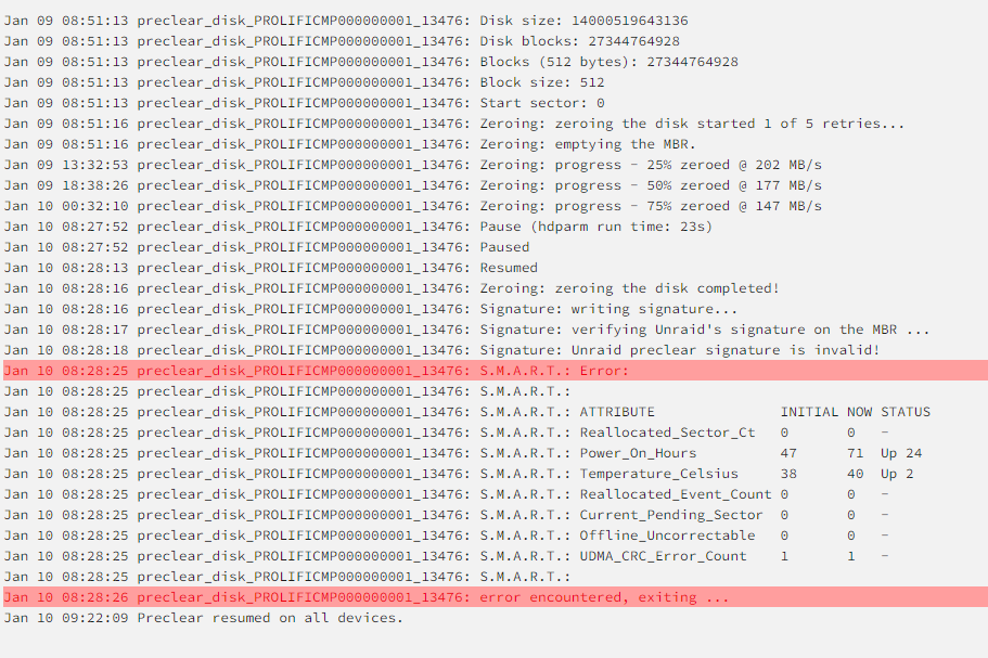

I tried running preclear again on the disk and once again it failed. This is what I found in the disk log information, does it help?

So I ran memtest and after 8 passes I don't have any memory errors.. still not sure what the solution is.
I tried connecting the drive directly to my server rather than using the external dock and ran a preclear but it still fails at the verifying Unraid's preclear signature step. I'm not sure if there's an issue with this drive or the preclear plugin.
I just tried to preclear a different disk and it once again also failed and got a invalid MBR signature from Unraid. Can someone verify the latest version of preclear is working with unraid 6.11.5?

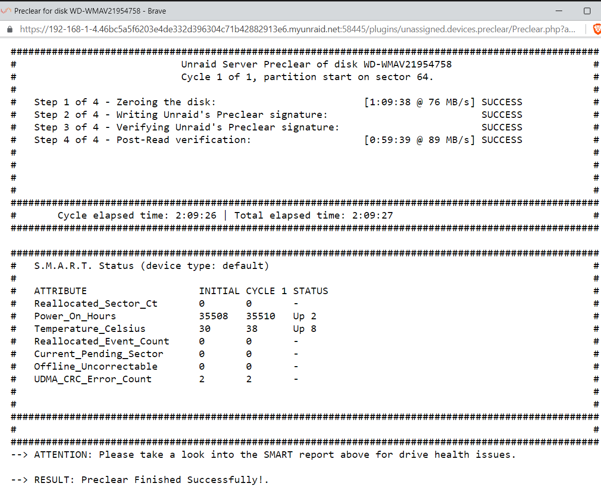

Working for me:
The script to do the preclear itself has not changed in a long time.  You might try the preclear docker and see if you get different results.
Thanks! Just ran preclear again with binhex docker preclear and it all passed okay. Weird how we couldn't figure out why it wasn't working with the preclear plugin. It used to work fine before 😅.
