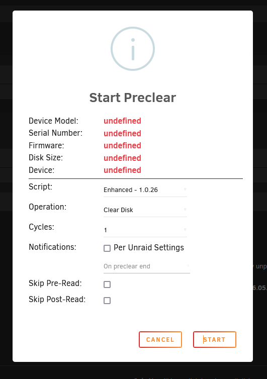

Hello,
I've swapped my Parity Disk (10TB SAS) with a 20TB(Sata).
Now I see the ex-Parity under unassigned but I can't preclear it to use it in the array.
I surely missing something here...
The little blue icon is the preclear button.
Yes I know, problem is it won't work 😞
immagine.thumb.png.1d14e4e594458f1036fb06a9c0320137.pngimmagine.png.4b24192d01f958e6c54f453daecd83e7.png
Even when the device size is correctly seen
Edited by TDA
Is the drive clear of all partitions? You cropped tight so can't see. If not clear them first.
Looks like UD sees a partition on the device.  Enable destructive mode and clear the disk (red 'X') next to the serial number.

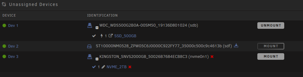

I just removed it from the Parity, and reconfigured unraid to forget about it.
I have destructive mode on - but unfortunately no X is appearing for this disk:
EDIT: Just out of the blue the X appeared and I was able to clear the disk.

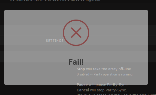

#   Step 3 of 5 - Writing Unraid's Preclear signature:                          SUCCESS            #
#   Step 4 of 5 - Verifying Unraid's Preclear signature:                        SUCCESS            #
#   Step 5 of 5 - Post-Read verification:                                          FAIL            #
Not sure if it happened while I knocked into the server case (doubt so though). How can I run Step 5 again without going through Step 1-4?
And if Step 5 fails again, should I run the whole preclear again? Or will it be grounds for an RMA (don't know what to write for a return)? FWIW I start in safe mode so there are no other activities going on  to interfere (drives are not mounted). Thanks for any advice in advance..
