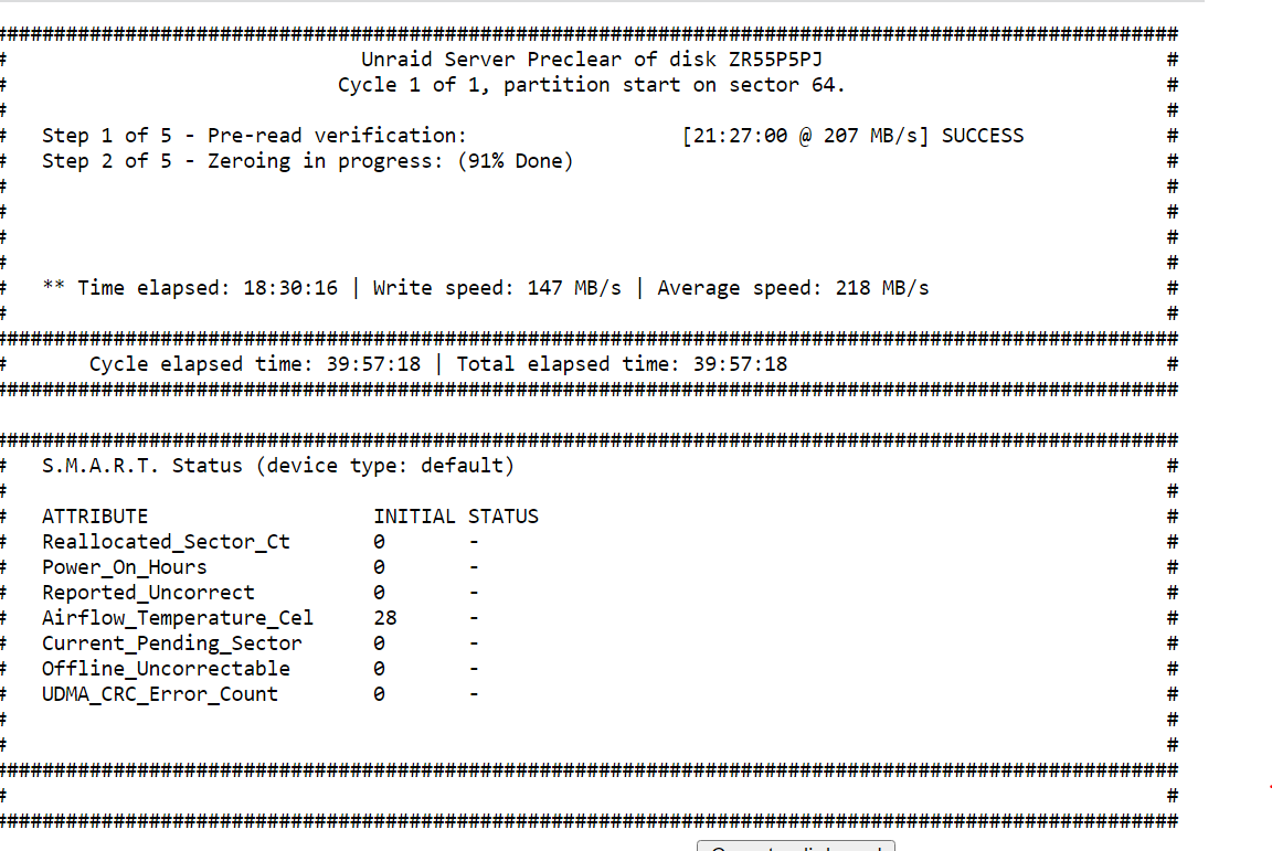

Does this do multiple passes on pre-clearing?
I'm running two pre-clears of 16tb exos and it already did the pre-read and almost done with the zeroing, but it says 2 of 5, does that mean its going to run 2 more passes before doing the post read? If so, how any way to stop extra zeroing passes?

One preclear pass is 5 steps.  It's indicating what steps are done in the preclear process.
Just wanted to make sure it wasn't doing multiple zero'ing passes.

Yes, but you can specify the number of zeroing passes (called cycles) up to a total of 3 if you want to do more.
