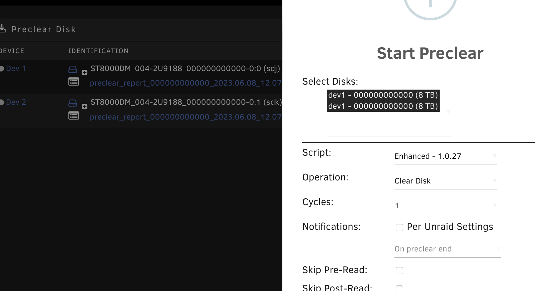

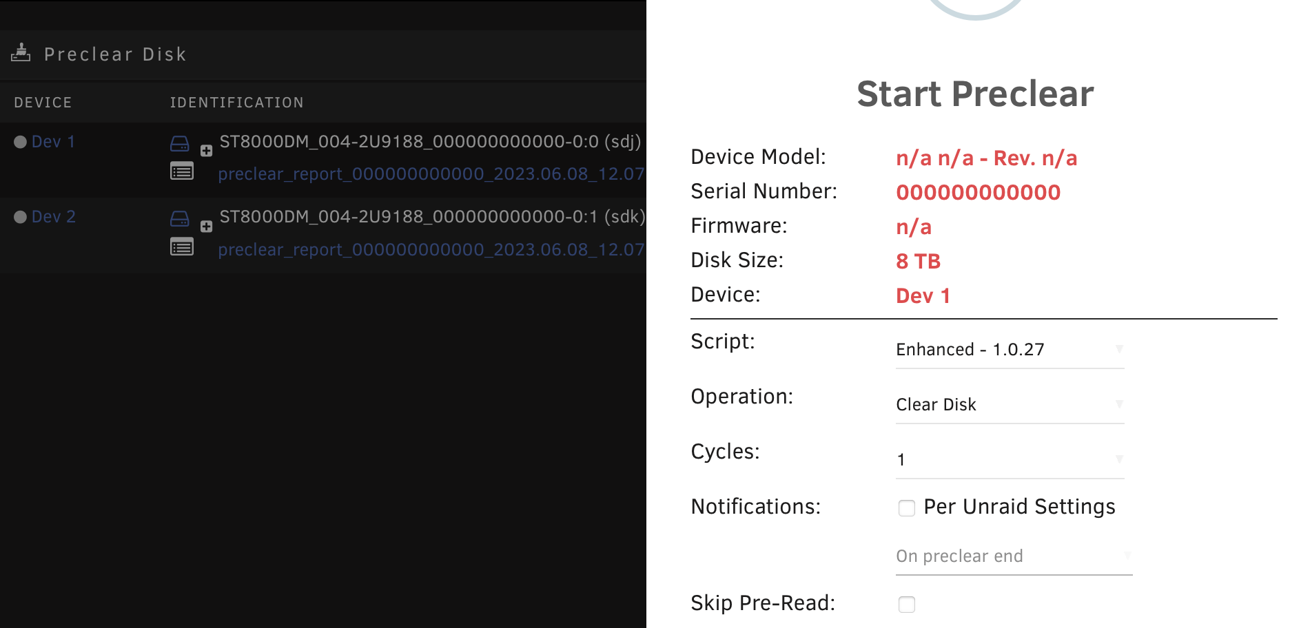

I think I dun goofed, and not sure if this is the best place to write about it?
I have 2 new 8TB drives and no free internal slots, so I connected a multibay USB JBOD enclosure, so unpaid unassigned devices saw both disks, I used the plugin to start pre clear , it says both drives will be done, hit start and 98 hours later it says complete.
but I only ever saw the one HDD drive flashing and only 1 drive shows 'pre cleared' but when I "+" in the tools menu, both drives have a pre clear file - I think the system got confused as both drives reporting as the same (both show DEV1) but one listed as sdj and one as sdk
so it didn't seem to be going any further, didn't say anywhere ok moving to next drive, but when I clicked the top square icon, the pre cleared status is gone for the one drive but the logs remain.
so, should I be removing and just doing 1 drive at a time? is it because they are the same model that confused things or am I way off?
(my plan was to pre clear both, then shut down, replace the smaller drive, let it rebuild then shut down and replace the next smallest drive)
any tips appreciated!
If the USB enclosure does not present the drives with different Id’s then it will not work properly with Unraid.
Ahh, I thought as it showed the two different device names it would be ok, I will remove 1 drive and do them individually, cheers!

I've been trying to preclear a set of new disks on a brand-new UnRAID 6.12.1 server for a week now.  I can always get 3 disks to finish preclear fine, but one of the four keeps restarting.  It gets to 99% on zeroing and then freezes, tries to restart at the sector it froze on, freezes again, and then restarts at 0%.
At first I thought it was the disk itself, but I swapped the disk with other array cables, and then that disk pre-cleared fine but the one plugged into the old port failed.  I figured I had a bad cable, so replaced that (It's a forward breakout 8087->SATA cable) ordered new and the same SATA plug failed, same drive as last time. This drive precleared previously on a different SATA port.
I'm seeing a very similar problem using the plugin version of the preclear script on 2 8tb SAS drives I got last week.  Both get to near the end of the zero phase, hang, and keep restarting until failure (I got the same restart at 0% on I think the 3rd retry attempt).  I installed the preclear docker image to test the original preclear script on my server (running 6.12.1 at the moment), and the first drive I tried has so far completed all the zeroing process with the preclear script that's included with the docker version, and is in the final read phase on the drive.  This was with 2 different manufacturers (one HGST, one Seagate Exos, both 8tb).  The Seagate ran through the zero process 3 total attempts, with 3 retries per attempt, and failed every time, the HGST failed a 3 retry pass before I started it using the docker.  I've currently got the Exos drive running a preclear on a virgin 6.11.5 install with just the preclear & UD plugins installed as a VM on my Proxmox server, with the drive passed through to that VM, and it's SO FAR at 83% and still going (VERY slowly, it's at I think 38 hrs on JUST the zero phase, lol, getting I think about 54m/s zero rate).  I'll let it go until it either completes, or fails on the zero, and move it back into my primary rig if it passes, and try it under the docker image too.  I DO notice that the Exos drive was shown as having a reported size of 8001563222016 total on the preclear plugin version n 6.12.1, where under 6.11.5 it's showing 7865536647168, so I'm not sure where, exactly it was getting the larger size from..  Same controller in both machines, only difference is it's being passed through to the VM directly, and not directly on bare metal.
As far as the HGST drive being in the final step (final read), I changed NOTHING on the server or plugins, just installed the plugin docker image (reports Docker 1.22), and started it using that instead of the canned preclear script with it's defaults..
