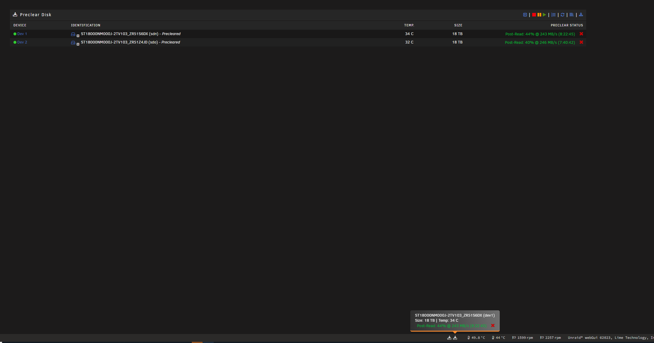

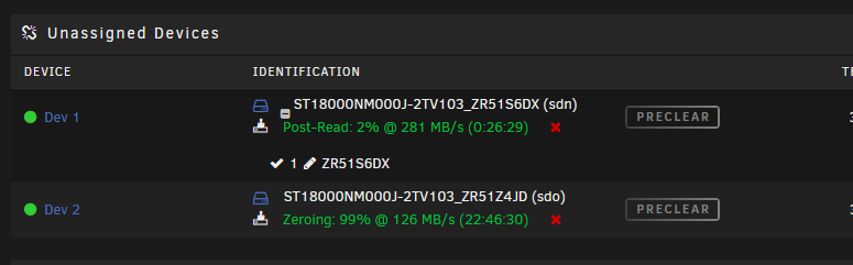

hi. been preclearing for the pass 2 days and so far everything seems smooth. just waiting it to finish
1 question, i was able to see detail stats before by pressing the eye icon beside the timer. its gone now. is becayse its in that stage and u cant see the stats? or there's some bug
The 'eye' status icon should always display.  It's probably a Browser issue.  Try clearing the cache or try another Browser.
You can go to the UD preclear page at Tools->Preclear Disk or the icon at the bottom of the Unraid webpage to see the status.
hmm its still doesnt show 'eye' icon. clear cached. tried multiple browser, edge and chrome. even in the preclear settings page

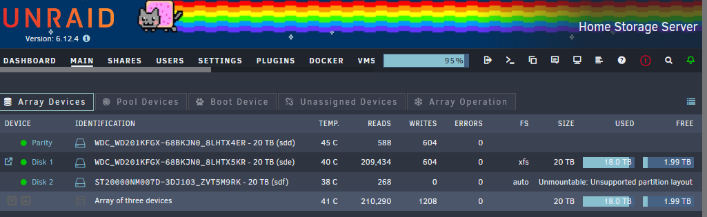

Guys, I'm just supremely confused here.
I just finished using UD Preclear and everything finished with no errors.
So I stopped the array, added the drive, and started the array.
I get the "Unmountable: Unsupoorted partition layout" message next to the drive and my storage has no increased.
The instructions say no need to format, and several posts here give conflicting information.
If I click the red X next to the drive, it tells me it'll remove the pre-clear signature and Unraid will start the lengthy preclear all over again.
I've tried rebooting as well.
I thought it was as simple as Preclear > Add to Array but seems I'm missing a step.
What am I missing guys?
Thank you!
That you need to format the drive after adding to array, you should have the format button available at the bottom with the disk you added in the list on the left.
Hmmm I don't have any buttons at the bottom of Unraid > Main > Array Devices
I do have a button under Unraid > Main > Array Operation called Format that says "will create a file system in all Unmountable disks" and when I click it, gives me the following warning:
Format Unmountable disks
Create an empty file system on the disks shown as Unmountable discarding all data currently on the disks and update parity to reflect this. This is typically done when a new disk is added to the array to get it ready for files to be written to it.
**WARNING**
A format is NEVER part of a data recovery or disk rebuild process and if done in such circumstances will normally lead to loss of all data on the disks being formatted.
Think I should go ahead and do that one?
Sorry, just trying to avoid another 4 day clearing.
Edited by DevanteWeary
That is the one, and yes as long as you've checked on the left of that button that the only unmountable drive listed is the one you just added to the array you go ahead.
Edited by Kilrah
Worked like a charm. You're the best. 😆
Just throwing the steps here for anyone looking for a definitive order:
  • Use UD Preclear on drive. (could take days)
  • Stop Array
  • Increase drive number by one.
  • Select new drive to fill new slot.
  • Start Array.
  • Format drive through Array Operations > Format
  • Done!
