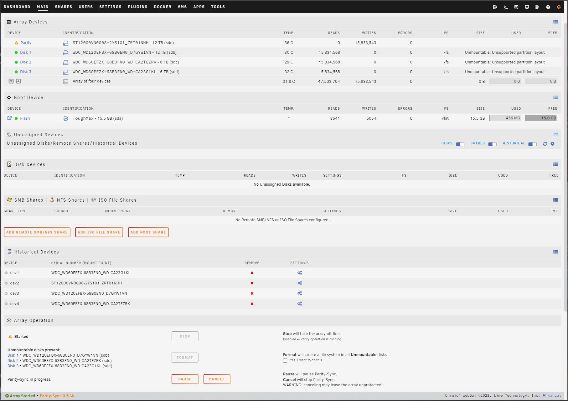

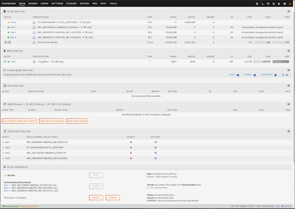

So my preclear finished this morning. I went ahead and assigned the disks to the array, explicitly specified xfs as the data drives format, and clicked start array. I wasn't prompted to confirm formatting the drives. It appears that it still wants me to format, but you guys made it pretty clear that I should not explicitly format the drives via the format button or it will erase the preclear signature. Should the drives appear as formatted after the parity sync is complete? As it stands, it doesn't appear as though they will be formatted.
25 minutes ago, dlandon said:
Are they all new disks?
Yea all new disks. Three of them were new in packaging (had zero power on hours) and one of them (a 6tb data drive) was taken from a prebuilt (5 power on hours iirc)
Edited by linksta7
additional info
It is fine to format them AFTER adding them to the array (and is in fact required).   What you must not do (as many users seem to do) is format them in UD after the Preclear but BEFORE adding them to the array.
Ah I see, I thought the formatting would take place as part of the array building process. I will format then now that preclear is complete and all the disks have been added to the array then. Thank you :)
A clear disk is all zeros. When you add a clear disk to a new slot in the array that already has valid parity, parity is still valid since all zeros has no effect on parity.
If you format a clear disk before adding it to the array, it is no longer all zeros, so Unraid has to clear it again so parity will remain valid.
Format is a write operation, it writes an empty filesystem to the disk. Unraid treats this write operation in the array just as it does any other, by updating parity. So after formatting a disk in the array, parity is in sync with the formatted disk. Please keep this in mind and don't format a disk in the array if it had data on it you wish to keep. Ask for help instead.
