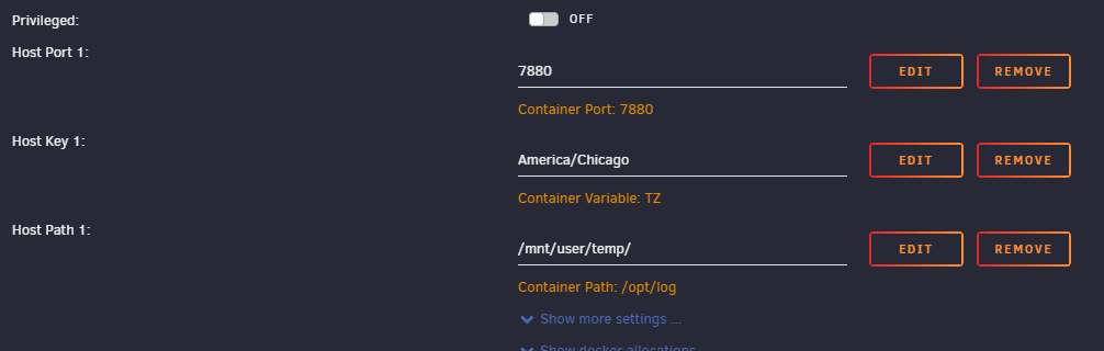

March 10, 20224 yr Author #1/2 - This app does not store any information. It just displays the nginx proxy manager logs via goaccess. #2 - The Host Path for /opt/log needs to point to your nginx proxy manager logs. It will then parse through proxy-host-*_access.log.gz and proxy-host-*_access.log filenames to generate the analytics. Logs are re-read every time the container restarts. #3 - GeoLite2-City.mmdb is stored within the container itself. I will be updating this in the next fews days to pull the newest version. The version currently in use is from 3/2/2022. This is supposed to be meant to be as straightforward as possible. You just need to set your port, time zone, and the location of your NPM logs. Everything should then work. Edited March 10, 20224 yr by xavierh

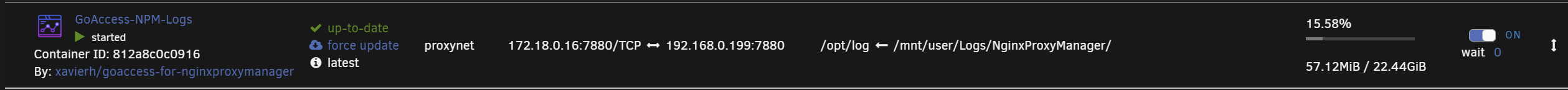

March 11, 20224 yr Author 1 hour ago, Masterwishx said: dont we need to mount appdata/GoAccess-NPM-Logs for goaccess/goaccess.conf file ? You just need to mount your log files and set your time zone. The goaccess.conf has already been configured within the container; no need to touch that or set that up. Edited March 11, 20224 yr by xavierh added screenshot
March 11, 20224 yr 1 hour ago, xavierh said: You just need to mount your log files and set your time zone. The goaccess.conf has already been configured within the container; no need to touch that or set that up. i already installed and its working without any problems, Thanks again.

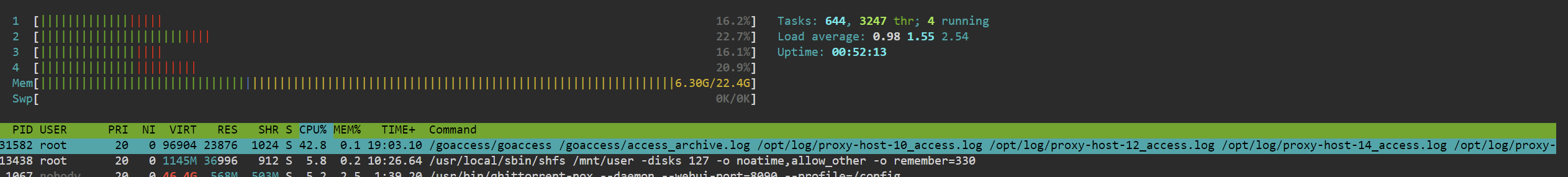

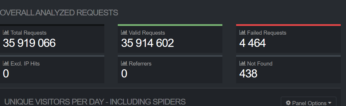

March 19, 20224 yr also i cansee like 15000 request adding every second this is can be right ?!? Edited March 19, 20224 yr by Masterwishx

May 9, 20224 yr On 3/19/2022 at 11:09 AM, Masterwishx said: also i cansee like 15000 request adding every second this is can be right ?!? Are you pointed to the 'log' or the 'logs' directory in NPM? I had the same issue pointed to the 'logs' folder, but switching it over to the NPM 'logs' folder fixed it. Almost seemed like it was recursively adding stuff from the 'log' folder
May 13, 20224 yr On 5/9/2022 at 6:05 PM, Agent531C said: Are you pointed to the 'log' or the 'logs' directory in NPM? I had the same issue pointed to the 'logs' folder, but switching it over to the NPM 'logs' folder fixed it. Almost seemed like it was recursively adding stuff from the 'log' folder im using /mnt/user/Logs/NginxProxyManager becose of old same docker using share - Logs
